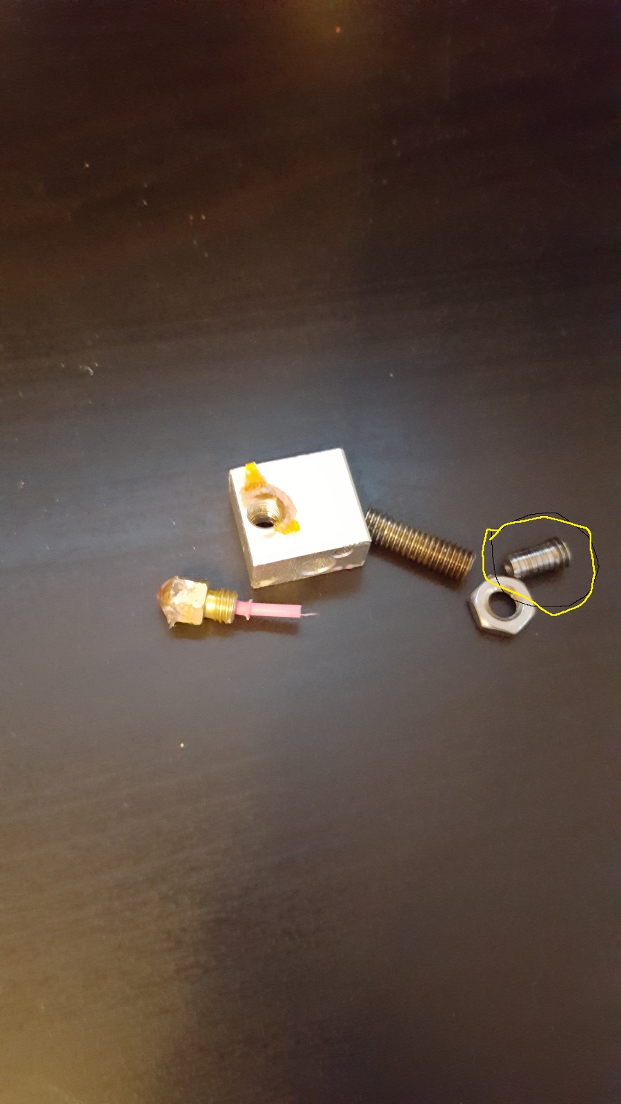

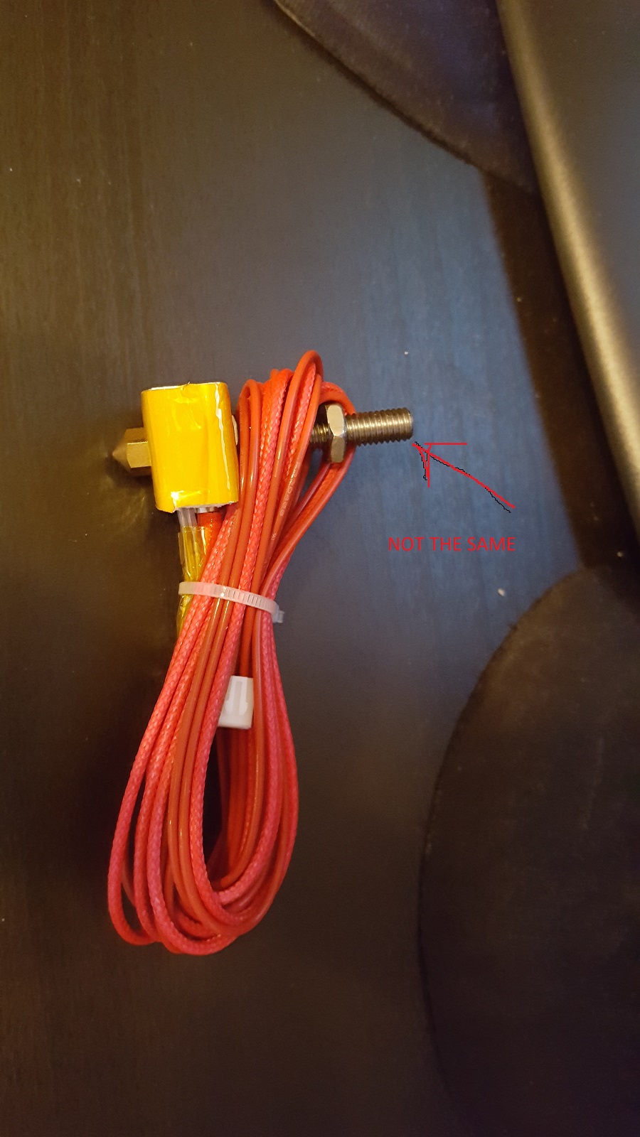

i broke the Hot end screw and i ordered from geeetech a replacement i ask them to send me the exact same hotend with the screw as that come original with the printer. they send me not the same piece and they say it is the same.
I send them picture and they don't seem to understand.
can someone help please.
I attach pictures and a video of what i mean.
Broken part
broken part
broken part
broken part_r.jpg (276.92 KiB) Viewed 13704 times
new from Geeetech
new from Geeetech
new from Geeetech
Here is a video of what i mean https://youtu.be/nvmS78dKRLo

Anyone know where spare nozzle throat to the Pro C can be purchased? all the ones i bought are threaded all the way up like one shown above.
Newopint95
Posts: 76
Joined: Sun Mar 12, 2017 8:14 pm
Re: geeetech pro c and hot end
Post by Newopint95 »
That looks like the correct part to me. In the video he keeps showing how it wont slide in, thats because it has to be threaded in. His old one had all the threads striped off thats why it looked different.
kasparp
Posts: 2
Joined: Wed Oct 08, 2014 8:46 pm
Post by kasparp »
It is not the right part, there is no room on the inside of the block it goes into, I have the same setup it cannot be threaded in.
Edit: The threads are removed from factory, the throat is fastened with a small screw that locks it in place not threads.
The throat rod of the single MK8 extruder is different from the throat rod of the dual extruder.
So, you need to tell the seller you need a hot-end of the dual extruder for Pro C.
