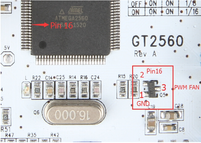

Re: GT2560 - PWM cooling fan suddenly not working
Will the fan ran after you connect it to the PWM-Fan? if not, I think you need to check the MOSFET, the PWM fan is controlled by the pin16 of the main chip. When you turn on the fan, then the voltage between the pin3 and pin1 of the MOSFET is 0V, and when off, it will be about 11-12V.

Thank you, i'll changhe the mosfet.
