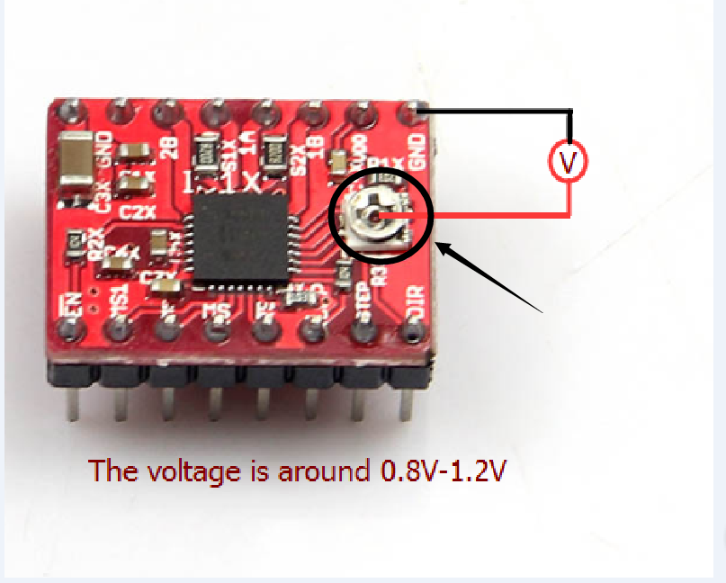

The voltage of A4988 is 0.8-1.2v in normal.You should ensure the voltage adjust to 0.8-1.2v.You can refer to it:

- QQ图片20150914174428.png (132.58 KiB) Viewed 31430 times

thanks…. of course.. what you say is right…okey…well.. but the problem is…I try to adjust it. but I can not do it .. when I turn the potentiometer screw the electric current it transmits between the volt and 0,2 while if I turn to the right goes beyond the 2 volt. which is the full scale of the tester. On the display, OL (out level) is too high in the current.
Then. I can not find the right position. could something be broken?
I've already tried to change the driver a4899 but with 2 other drivers it has the same result. could the control card be broken?
Am I mistaken to do something?
The screw rotates less than 1/8 turn at a time. but there is a point where if the screw is very small on the left the measurement is 0.050 if it is very small to the right I measure more than 2 volts

Do I want to know what is your model? I am curious what you have all three control panel this situation.Maybe the reason for the adjustment way?
Maybe you can remove the other A4988, leaving only one A4988. Then test, and try to adjust its voltage.
If none of these methods work, then you can buy a new A4988 installed to see if it's voltage is adjustable and normal.
- ADJUST.png (206.02 KiB) Viewed 31413 times
