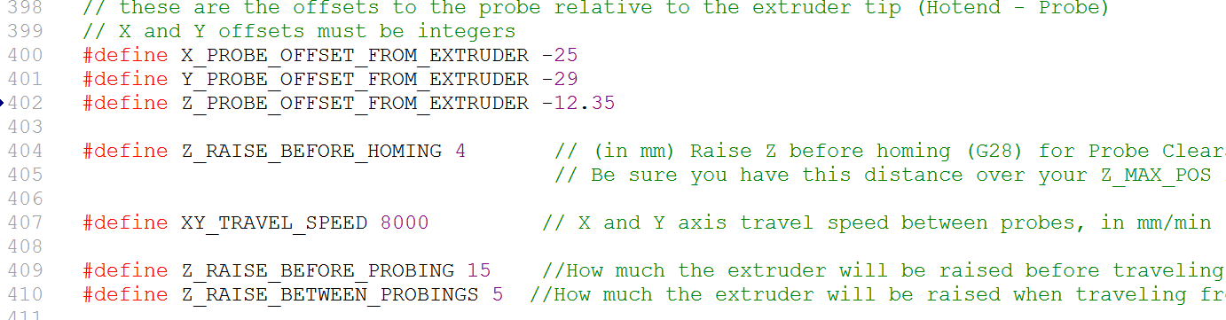

Re: 3D Touch Calibration - Can't move to negative Z position
You should change these lines(Please modify your firmware according to actual condition, this is an unmodified firmware, just for example only)
