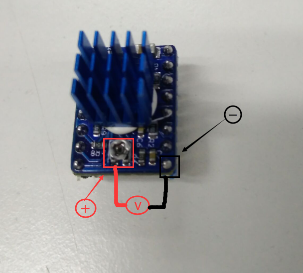

Could you upload the video about the issue?
What info have I get is:
The voltage of A4988(blue type) seems not correct(0.7-1.0V)
You can use a multimeter for a test
How to increase it up to 0.7-1.0V?
You can adjust it by the top adjustable resistor
