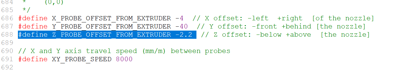

Re: 3D Touch Sensor:Auto-levelling for Geeetech 3D printer
I think you should check this line

Hi Willem,
It seems there are 2 ways to connect black-white wires of the 3D/BL Touch sensor:
1. Z-MIN:
You have to use the folowing entries in the firmware (1.1.7 or higher)
#define Z_MIN_PROBE_USES_Z_MIN_ENDSTOP_PIN
#define Z_SAFE_HOMING
2. Z-MAX
#define Z_MIN_PROBE_ENDSTOP
#define Z_MIN_PROBE_PIN 32
When u use te Z-MIN, the homing to the Z-Axis must be derived from the sensor and the middle of the bed is a secure place for the sensor. you can configure the Z_SAFE_HOMING point by adjusting the values of
Z_SAFE_HOMING_X_POINT and Z_SAFE_HOMING_Y_POINT
In situation 2 you still have the Z-Min switch which means this switch can be used for Homing and it just will. You don't need the Z_SAFE_HOMING
In my setup, I have situation 2, defining the Z_PROBE_OFFSET_FROM_EXTRUDER in the firmware didn't work.
It seems that the value saved in the EEPROM will overwrite the values set in the firmware.
In Reptier-Host I issued the M851 Z-1.6 and M500. This saved the value in the EEPROM, and was futher used.
You can check the value in the EEPROM by issue M503( for all values)
and check the current setting with just issueing M851 ( with nothing more )
and when you reconnect to the printer in Reptier-Host, you will see all the values.
Success
kind regards,
Joris

Dear Joris and William,
My printer is working now thanks to your advice!
I changed the Z_probe offset and I followed the advice issued by Joris, methode 2 works fine with me.
