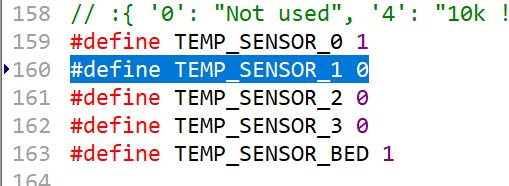

Now i want to switch my two nozzle heatend from G2S to the 301 Diamond heatend. Of course just with 2 Extruders instead of 3.
My Problem now in the Firmware is:
G2S has two heating elements, each per hotend, now i have just one heating element for both hotends.
Can u please tell me at wich line in the Firmware i can fix it? In my opinion the Firmware has to know that for Extruder 1 and 2 had to use heating element and thermisor of Extruder 1.
I hope you understand me ;-)
Can u please help?
Re: Delta G2S with 301 Diamond Nozzle
Remove the second one
And you need to change this line
