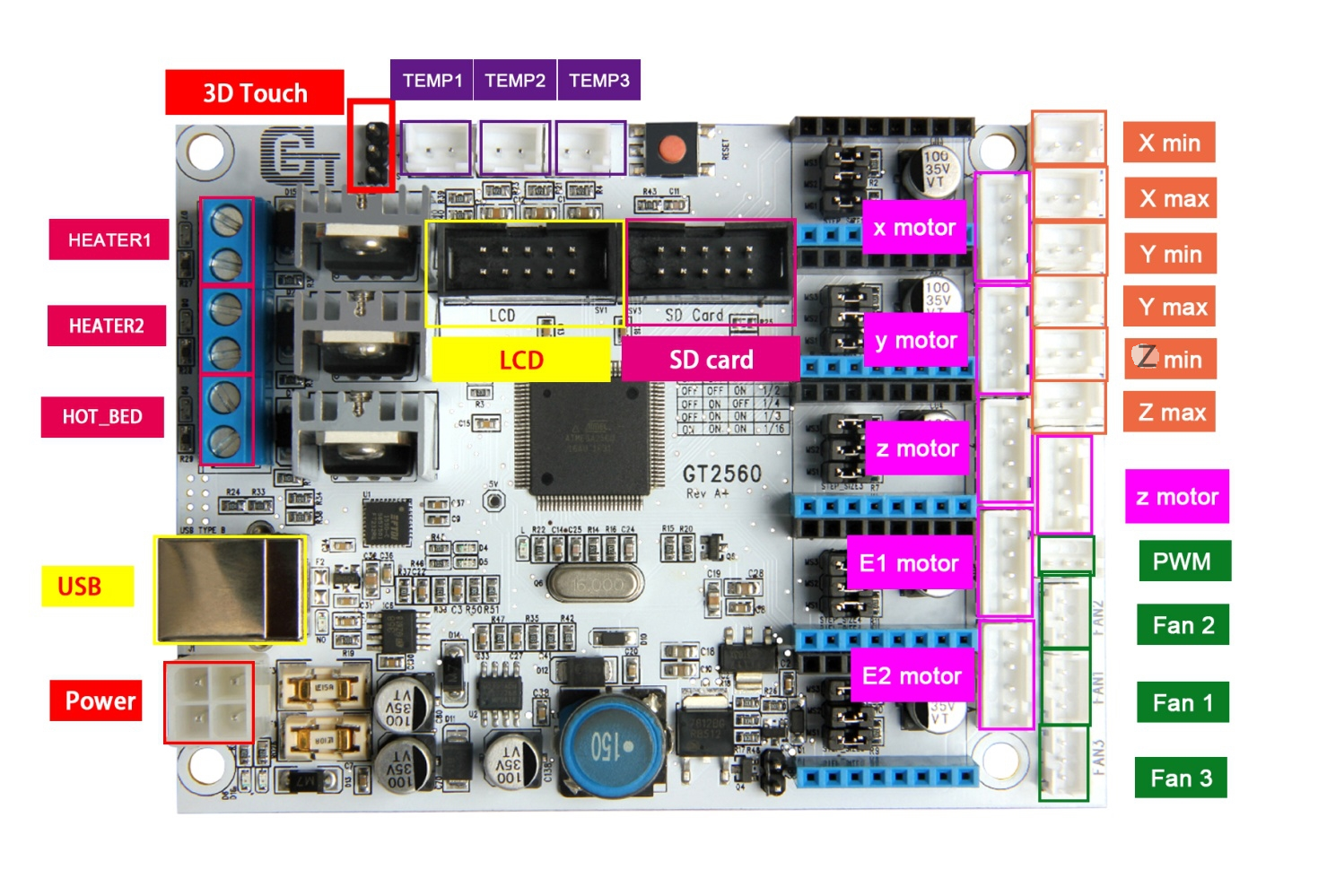

Hi, I need to increase the voltage on my extruder, as it keeps on skipping. I have cleaned the nozzle, checked the feed & done all the other recommended things. All that I have left to try is to increase the voltage. I have a Pro W with a GT2560A+ board & one extruder.
The GT2560A+ takes 5 A4988 stepper drivers, 3 for X/Y/Z axis, and 2 for extruders - & on my board I have a row of 5 sockets, only 4 of which are filled. However, I can't find anything in the Wiki or the forums which tells me WHICH A4988 stepper driver is which.

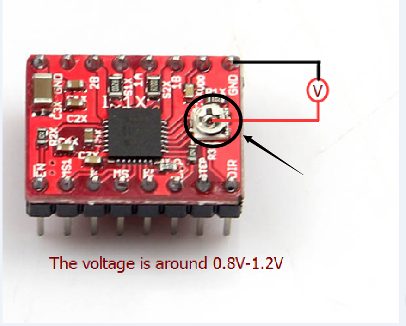

You should refer to this picture

Thanks William, but I know where the pot is on the A4988 Stepper Motor Driver.
I just have a choice of FOUR A4988's to choose from, & was asking which one is the one that runs the extruder - as that's the one that I need to change the voltage on.

You can refer to this picture

Thanks William, this is exactly what I was looking for. You're brilliant.
