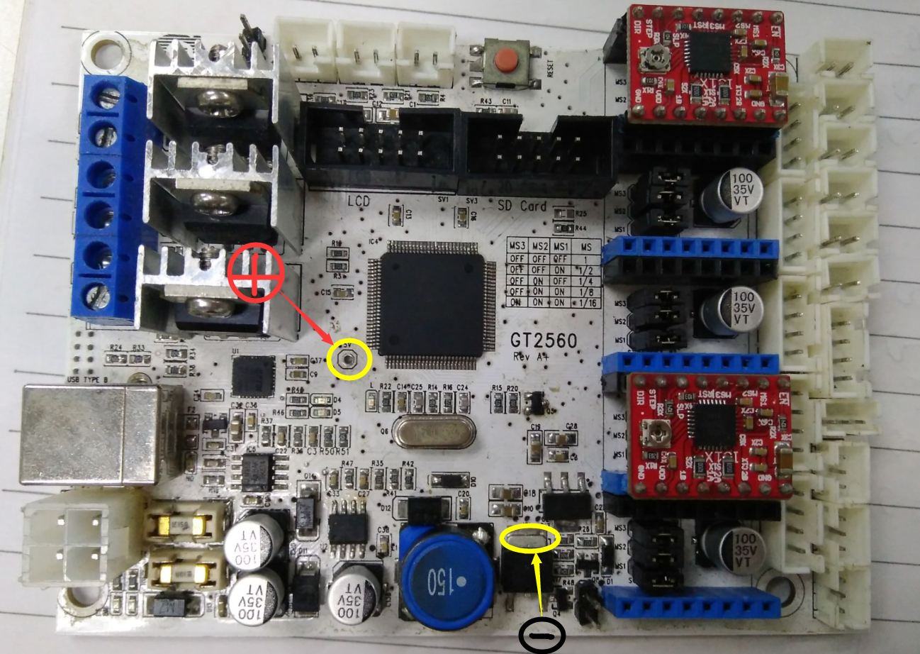

I think you can refer to this picture(Normal is 5V)
1.Plug PSU and disconnect USB cable
2.Plug USB cable and disconnect the PSU(3.8----5V)
