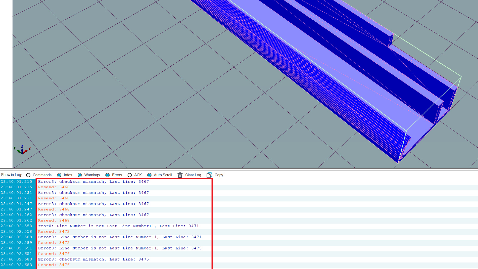

The USB Serial communication between the PC and printer stops responding randomly after 20-30 minute when used with Repetier Host.
This happens also in EasyPrint but not so often. Attached the screenshot from Repetier. This happens with two different computers and two different cables.
- g6.png (452.05 KiB) Viewed 11006 times

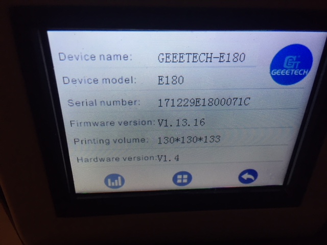

Re: USB/Serial communications issues
Have you tried to update the firmware?
You can upload the pic about your printer firmware info
Yes. I did. I run 1.13.16
- IMG_7240.JPG (73.56 KiB) Viewed 10935 times

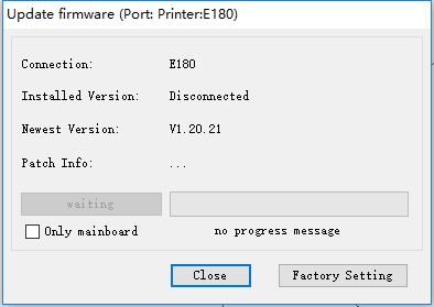

I think you can update the firmware to V1.20.21
