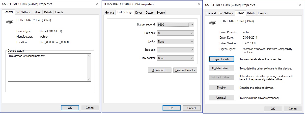

1. I plugged the USB connector of the 3Dprinter and my Windows 10 PC correctly istalled the CH340C driver for the USB to COM bridge (see attachment prusa-i3-pro-w-1 [attachment=2]prusa-i3-pro-w-1.jpg[/attachment])

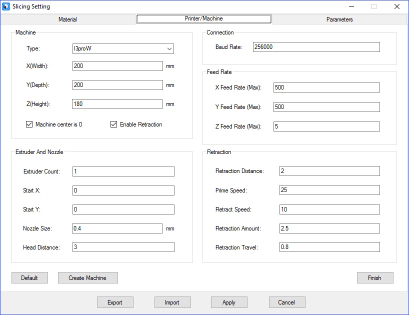

2. I have downloaded and installed the EasyPrint 3D 1.1.7, configured the COM port and the Printer (see attachment prusa-i3-pro-w-2 [attachment=1]prusa-i3-pro-w-2.jpg[/attachment])

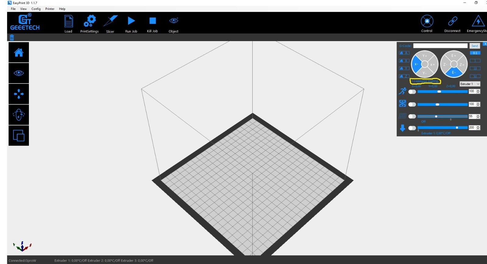

3. When I try to print an stl file or simply issue a single command to the Printer, by means of Control Window, nothing happens in printer side, in particular, if I send single command to the Printer in the Control Window appears a message "1 Command Waiting" (see attachment prusa-i3-pro-w-3 [attachment=0]prusa-i3-pro-w-3.jpg[/attachment]), the count increase if i send other commands.
It seems a communication problem between the OC and the printer but I can't find the causes, could you please help me?

Thank you very much William for the suggestion, I tried to set 250000 in the driver settings but it is an unavailable option, so I tried lower allowed values both in the "Bit per second" of the driver and "Baud rate" of the printers settings (like 128000 and 115200, and finally the default for the driver: 9600) but nothing happens.

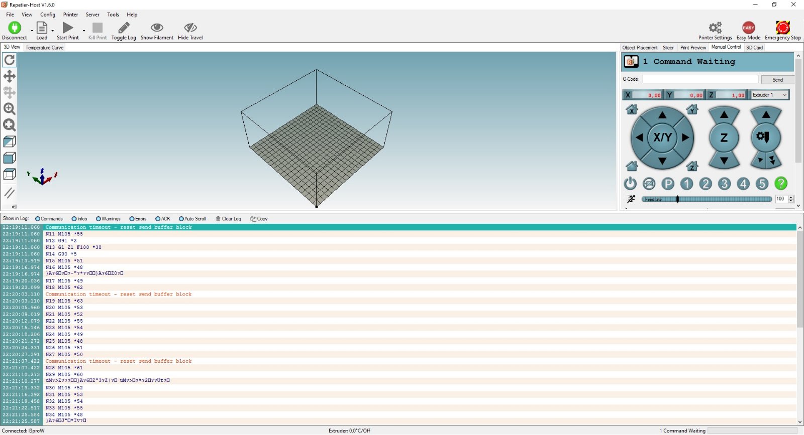

Hi all,
I have also downloaded the software repetier host and tried to use the Manual control, in the bottom there is a log windows, I tried to connect to the printer and to send a single command for the Z axe below a screenshot of the result:
[attachment=0]prusa-i3-pro-w-4.jpg[/attachment]

Thank you william the right settings for baud rate is 250000, thank you very much for your help, now the EasyPrint 3D sw can communicate with the printer.
Two things were confusing for me:
1. The default setting of 256000 in the I3 pro W in EasyPrint 3D Printer configuration:
2. the fact that this is not a choice in the Bit rate combo of the configuration dialog of the USB to COM port.

Re: I3 Pro W EasyPrint 3D 1.1.7 problems
Baud rate:256000(You can set this value for uploading the firmware)
Baud rate:250000 (You can set this value for printing)
