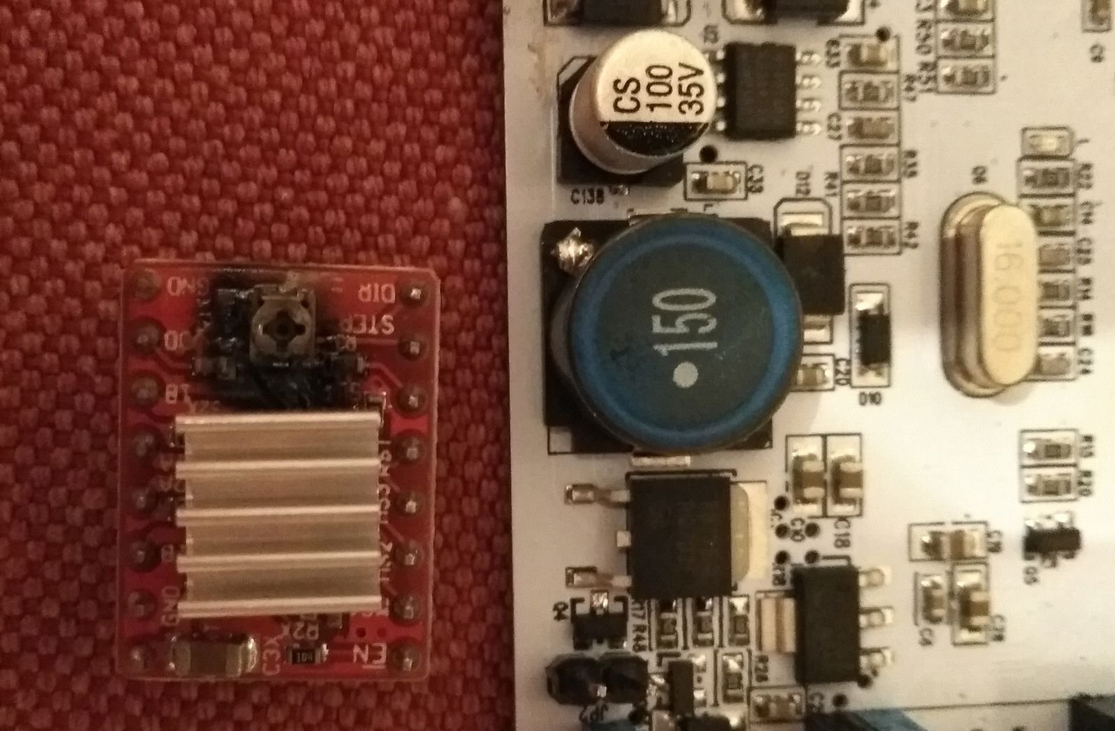

Removed USB and applied power - Inductor '150' and Voltage regulator became extremely hot after 30 seconds - I was surprised they did not melt.
I have included a picture of the initial stepper driver that failed - Do these have temperature protection?
The fuses are OK and I have inspected the board under a microscope and everything appears to be normal except the slight discolouring of the voltage regulator. Board draws in excess of 5 Amps with just the power connected.

[attachment=0]Board Snipit.jpg[/attachment]
- Board Snipit.jpg (230.22 KiB) Viewed 17242 times
Re: GT2560 Rev A+ Board Voltage regulator issue
It looks like A4988 seems to be short-circuited before it comes to such a result
