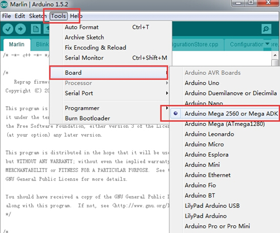

Hi Wes,
I'm very much a newbie and have only made some basic firmware changes with Arduino, but I can't get your 1.1.8 version to compile and get lots of errors like the one given below. I know that this will be something simple (and obvious) but I would be really grateful if you could point mt in the right direction!

Arduino: 1.8.4 (Windows 10), Board: "Arduino/Genuino Uno"
In file included from sketch\MarlinConfig.h:26:0,
from C:\I3 Pro X TEST\Marlin 1.1.8 Pro B _BL Touch\Marlin-1.1.8\Marlin\Marlin.ino:31:
fastio.h:56: error: #error "Pins for this chip not defined in Arduino.h! If you have a working pins definition, please contribute!"
fastio.h:314: error: #error "unknown CPU"
In file included from sketch\pins_GT2560_REV_A_PLUS.h:29:0,
from sketch\pins.h:172,
from sketch\MarlinConfig.h:34,
pins_GT2560_REV_A.h:30: error: #error "Oops! Make sure you have 'Arduino Mega' selected from the 'Tools -> Boards' menu."
exit status 1

Maybe you can check the board that you selected.

- Board.jpg (211.87 KiB) Viewed 16627 times
