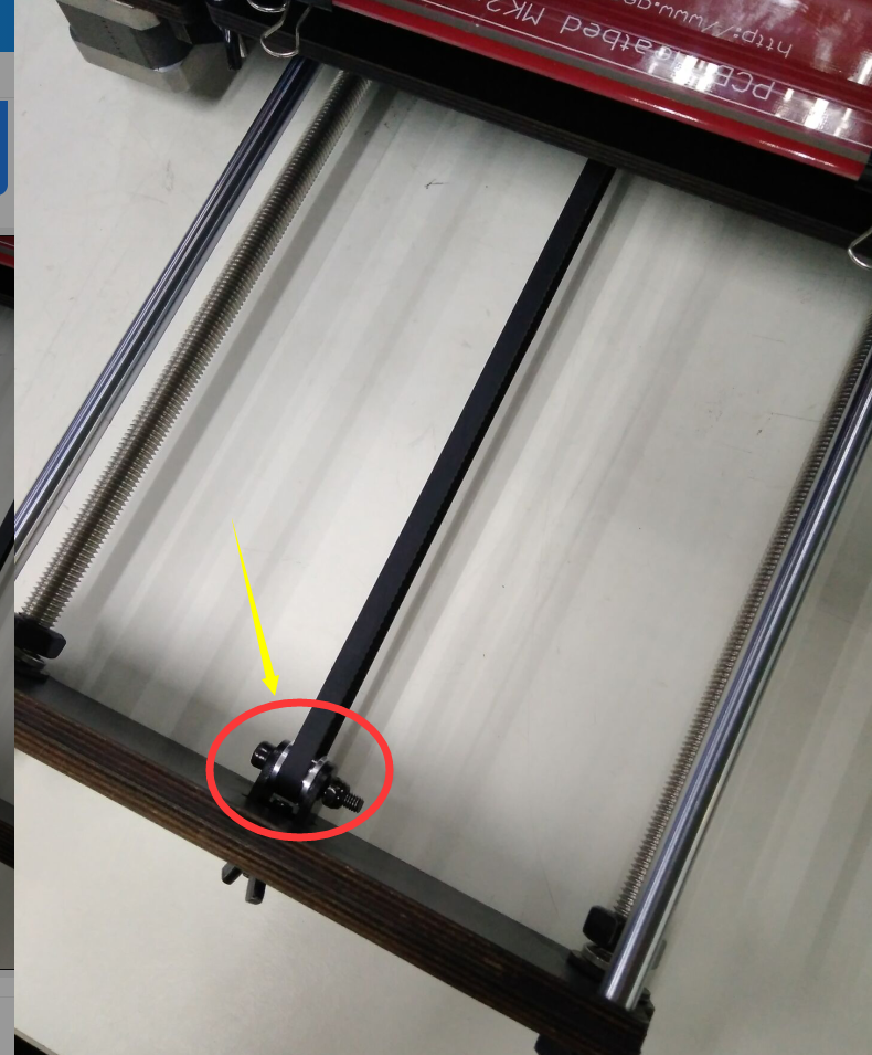

1.You can refer to this pic, loosen it a little
Y motor.png (839.18 KiB) Viewed 21840 times
