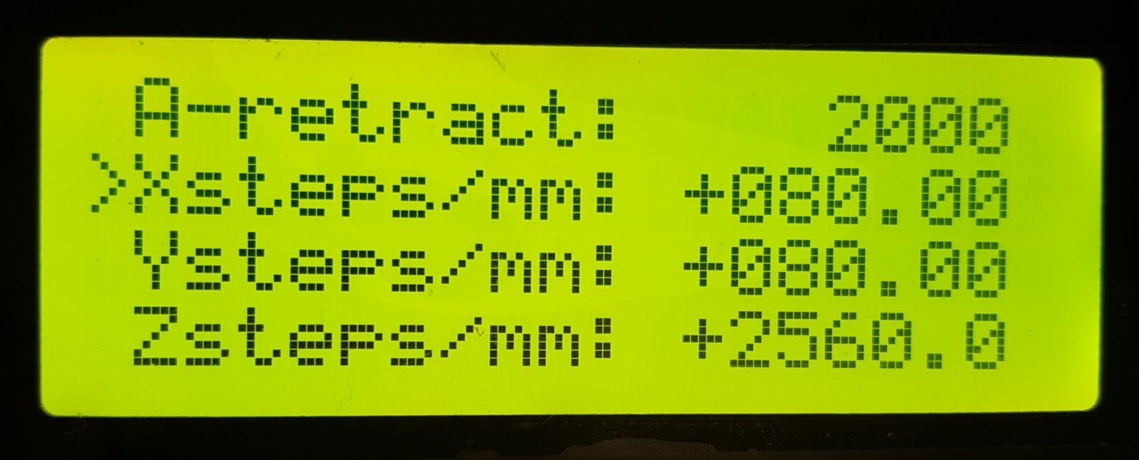

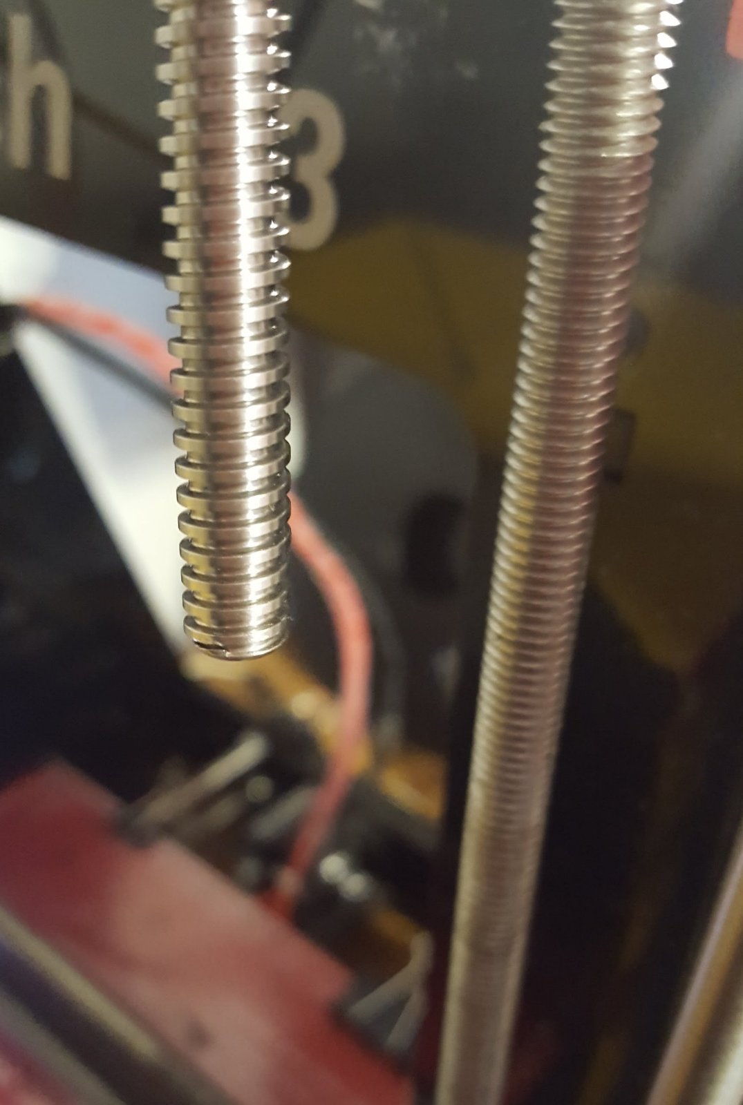

I'd like to replace my zaxis threaded rods as they arrived bent in multiple locations and it's finally annoyed me enough to change to new lead screws.
I assume I'll need to make changes to the firmware for the new steps or would it be possible to just change Z steps from 2560 to 1600?

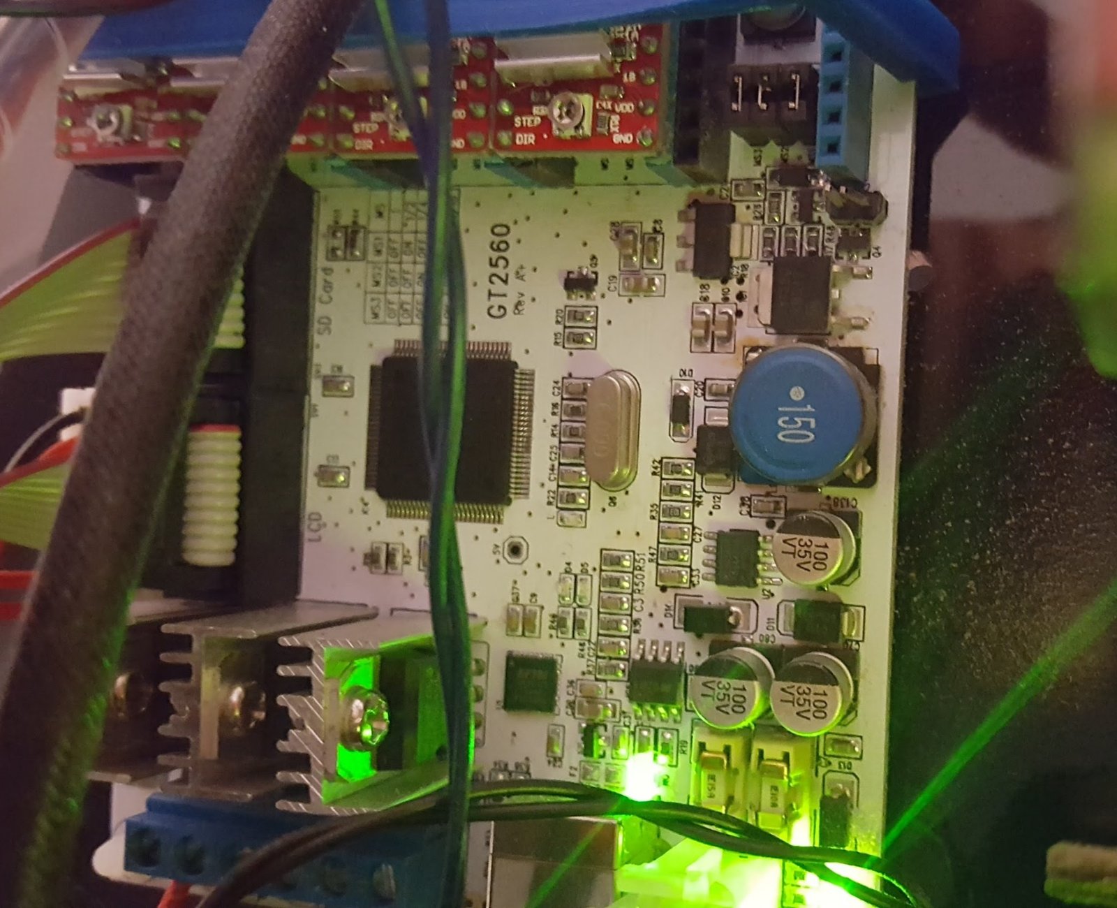

I assume I have the Sanguinololu motherboard (pictured)
When I issue M115 I get:
FIRMWARE_NAME:V1.0.03 Sprinter/grbl mashup for gen6 FIRMWARE_URL:https://github.com/Ultimaker/Marlin PROTOCOL_VERSION:1.0 MACHINE_TYPE:I3proB EXTRUDER_COUNT:1 UUID:00000000-0000-0000-0000-000000000000
