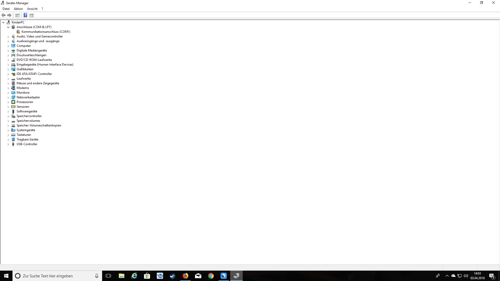

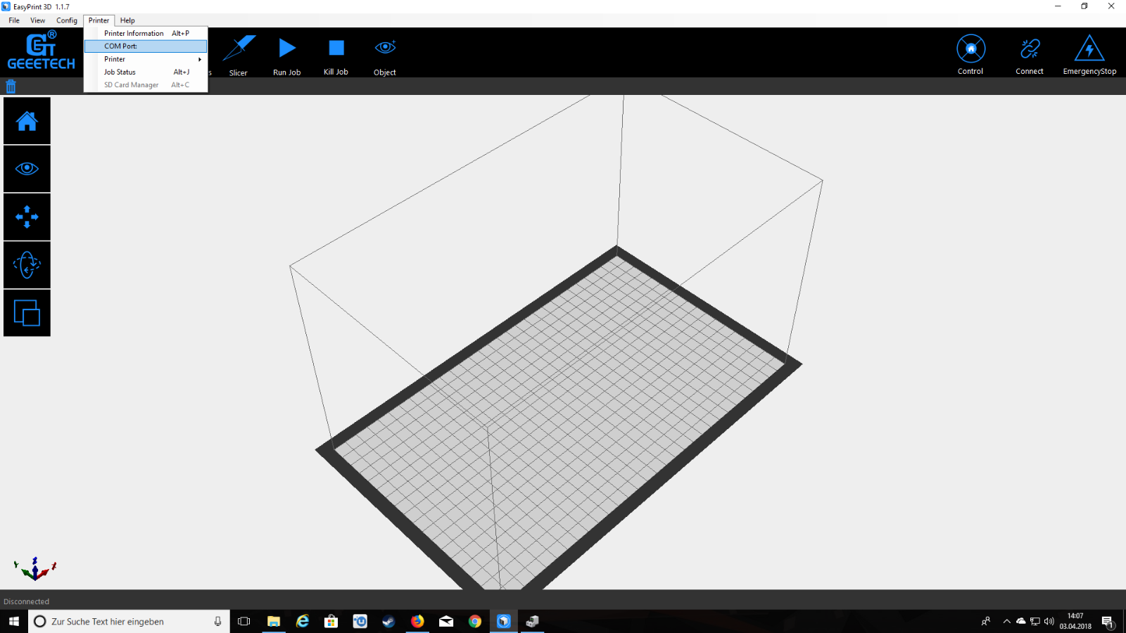

I have a problem. when I start Easy Print 3D and try to choose a Com Port there are no com Ports. I had installed the driver manually, but In the device Manager , there isn't the serial port like the port in the picture of the manual. So how am I able to connect the Printer?

- But still, I can't connect my Com Port
- Screenshot (2).png (170.64 KiB) Viewed 13397 times
- This Is my Device Manager
- Screenshot (1).png (96.92 KiB) Viewed 13397 times

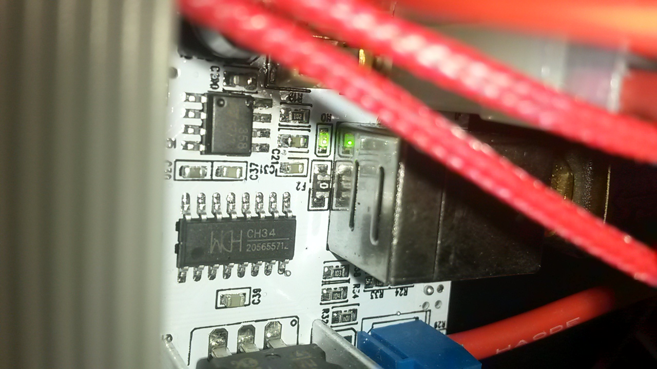

- I had used CH340_EXE for this Chip.
- 20180403_141642[1].jpg (287.35 KiB) Viewed 13397 times

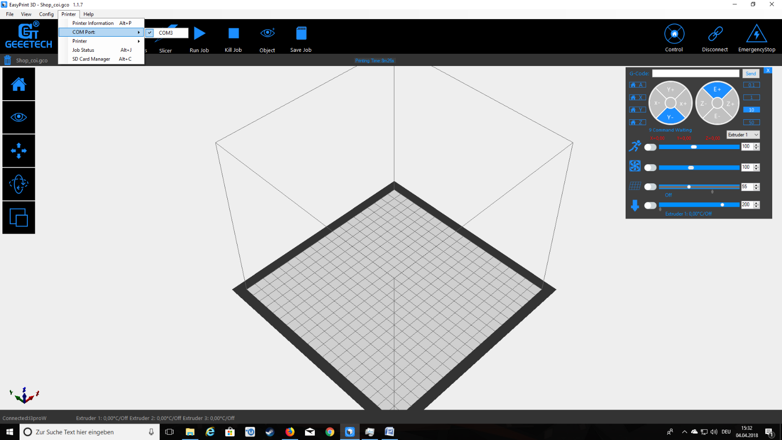

Thanks. I have now a connection in the com port (Com3), but the printer get no commands.
At the bottom of Easy Print 3D is written:"connected:I3ProW Extruder 1: 0,00°C/Off "...
but on the printer it sais "180/180°" hot and it feels Very hot.
Why arn't the information going thrue?It is connected (isn't it?).
By the way In "Control" is written "9 Command Waiting".
[attachment=0]Screenshot (3).png[/attachment]
I hope you could help me.

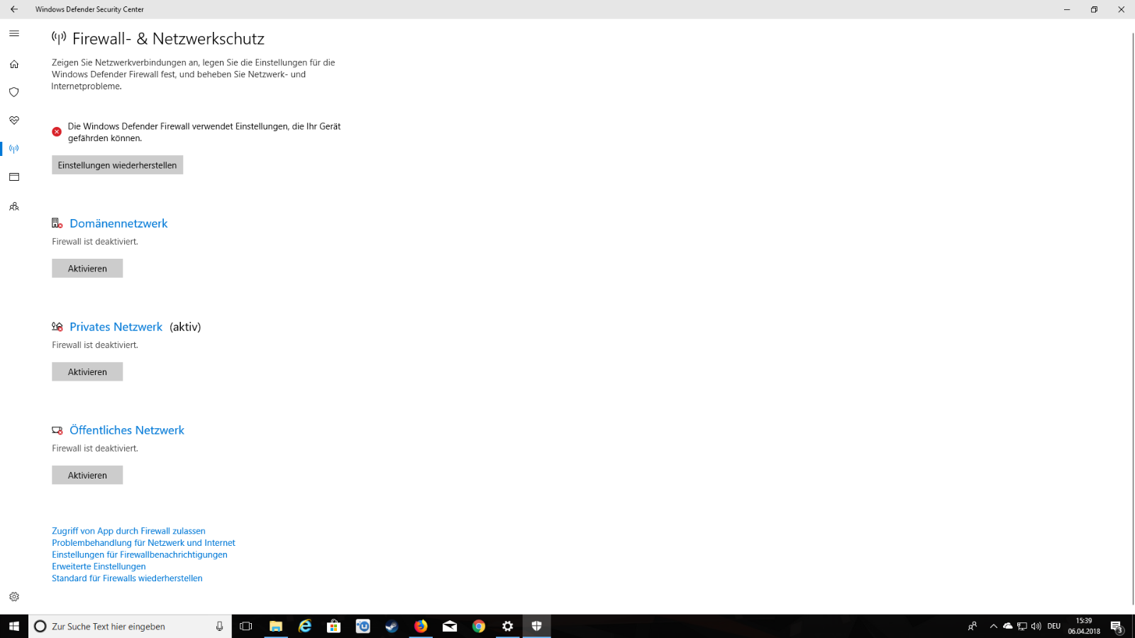

okay, turn off your firewall William said before.

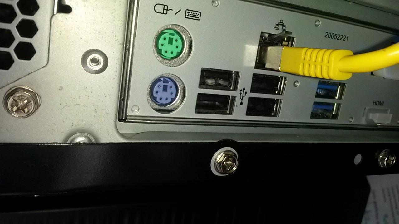

I have 6 USb ports in the back.(top left is destroyed of the first Power Adapter)
Are the black one USB2 and the blue USB3 or Is it USB and USB2?
I had noticed that the PC makes noise if I plug in keyboard or Mouse,
but it hadn't made any noise when i conected the printer.

When I Install CH341_EXE my firewall looks like that:
