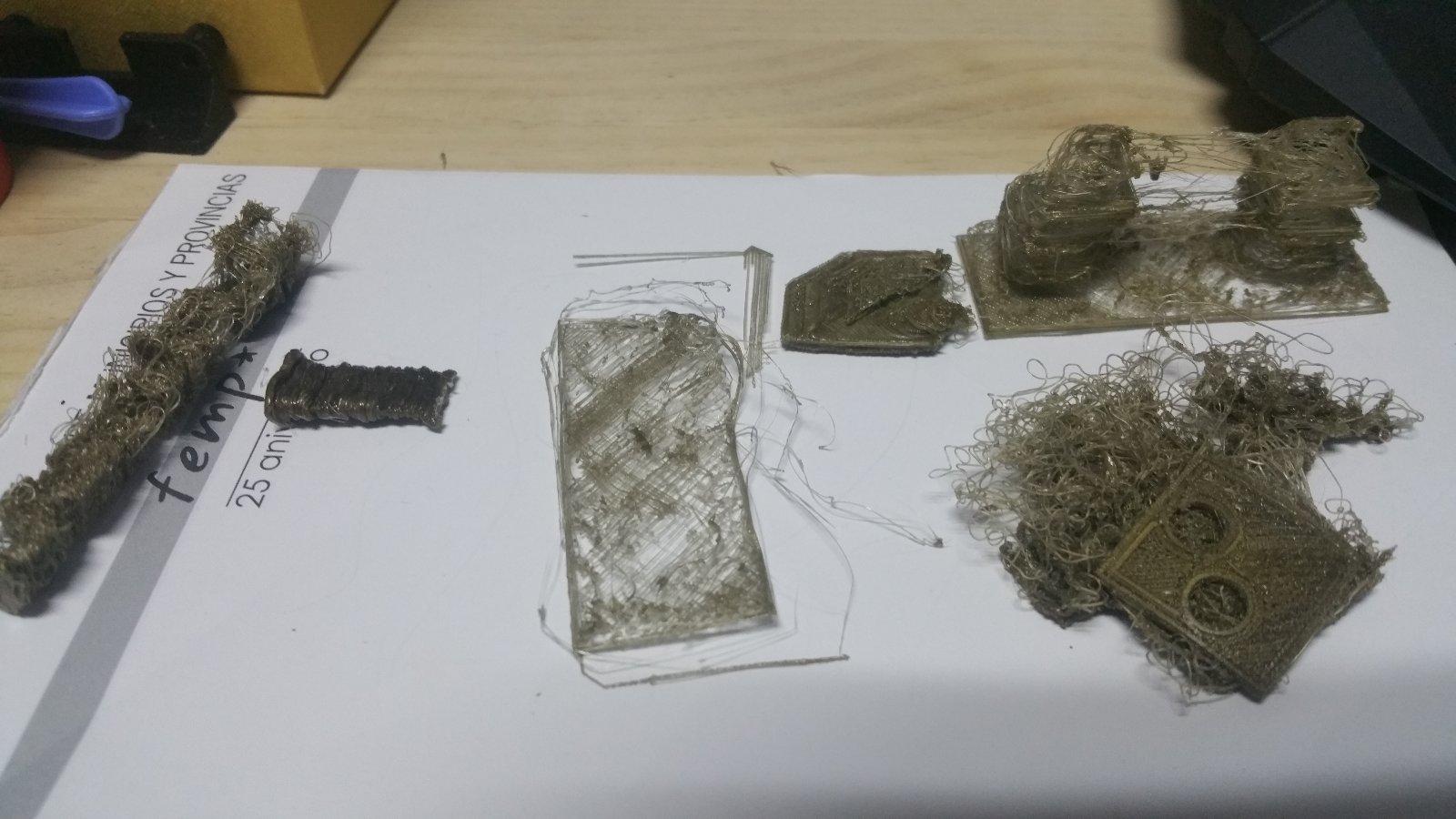

Hello, I am trying to make the latest version of Marlin work, the 1.1.8 and the truth is that I can not get it to work, I only get it to move correctly with version 1.0.04 that is downloaded from EasyPrint3D, but still I can not get it to print Well, it only prints me by the Repetier-Host and of this quality, with the EasyPrint3D directly it does not print me, the printer is connected but it does not do anything, and with the Cura he always prints it out of the platform, having activated that he always prints in the center of this,
Someone could help me..?

- 20180401_234510.jpg (182.73 KiB) Viewed 11869 times

1.Check the belt of Y axis and Z axis|
2.Check the wiring of the mainboard
If it is allowed, you can upload the picture of the wiring
3.You can try to check the temp of the nozzle
For PLA:180C~220c
4.You can refer to these post
viewtopic.php?f=19&t=17097
viewtopic.php?f=19&t=18507

Looks to me like you have under extrusion and the prints are not sticking to the bed.
For the under extrusion try increasing your nozzle temperature, go for about 210 to 215 for PLA to start with and work down until you see a degradation in print quality. Also if you are printing at 70 - 80 mm/s slow down your print speed to 30 -35 mms and see if that helps.
For the not sticking to the bed there are a number of different things to try, but the easiest to do is make sure the bed is properly levelled and at the right height for the nozzle, adjust the corner screws until a single sheet of paper just about fits under the nozzle without you putting any pressure on the bed. Give the glass a good clean with IPA or mentholated spirits and heat it to around 60 deg C for PLA. If you are printing something without much surface to contact the bed use a brim to help with adhesion.

You can also try to slow down first layer speed to about 15mms, helps a lot.
