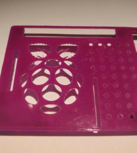

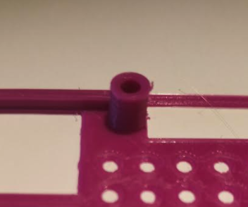

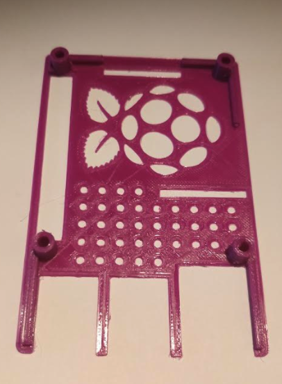

I'll post my working version at some point and I have attached a few images of a pi case top I have printed.
I'm sure most of my remaining issues can be resolved with some minor calibration which I will continue to do with more time.
