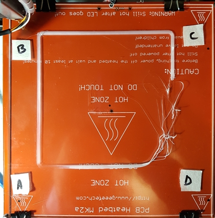

I inverted the threaded rods and the Z-Steppers from the right side with the left one, but the result does not change, the plate is not aligned in the four points B and C are at the right level for the extruder, point A is too high the point D is too low and the material does not stick to the plane (a picture is better than a hundred words).
For this test I used the most versatile "Marlin-1.1.x.rar" firmware for setting the Z-offset.
Thanks for any help
Greetings Massimo

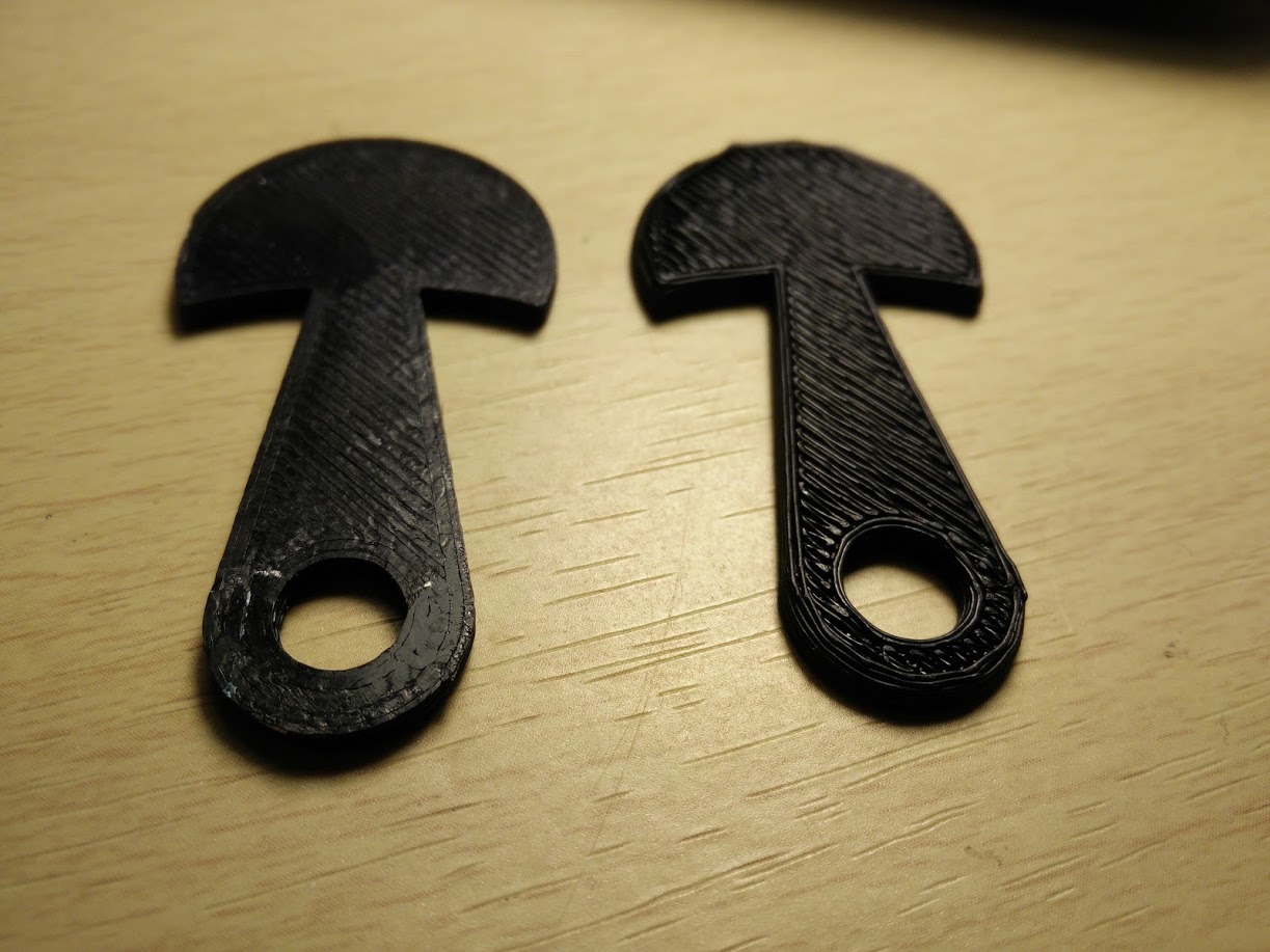

Hi there,
I'm having this issue and I can't print large pieces because of this.
I've attached a print, the 2 pieces were on the oposite side of the bed.
[attachment=0]IMG_20170505_205447.jpg[/attachment]
We need to figure what is happening, I tried different firmware with the same results.
