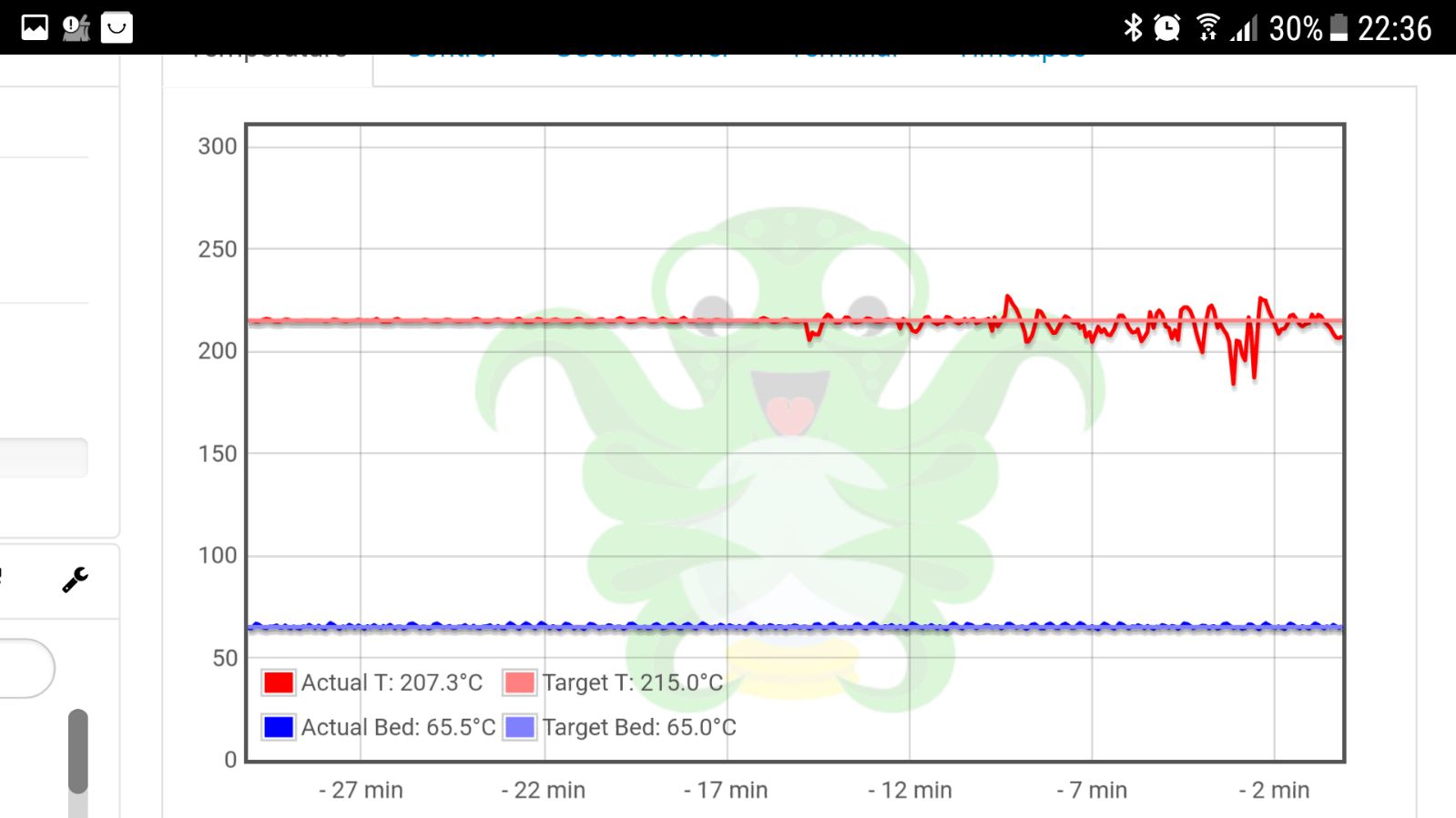

I have problems with the temperature of the hotend, practically after an undefined time it begins to be inconstant.
I also performed the PID calibration but without success.
do you think it's a problem of the resistance of the hot end? of the sensor? or even the main board?
I attach screen.
and thank you all in advance for the help.

As you think, there may be some electrical breaks on the wiring connections.
But also a breath of fresh air if the printer is in an open space.
That's my opinion.
Re: Problem HotEnd Temp
1.You can try to check the mosfet>>>If it were too hot, you need to replace it
2.You can try to re-adjust PID
3.A new hotend will fix this issue

solved by replacing the hot-end
