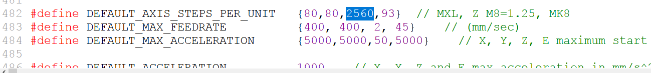

Re: Basic guide to lead screw upgrade, i3 Pro B
You can refer to this

Ok, thanks. But..
1) that setting doesn’t seem to get remembered by the printer.
And 2) the head doesn’t return to correct Z origin and judders when trying to move.
Is it because the motors aren’t suitable for a steps value of as little as 400? Should I swap back to threaded rod?

@William
I've just added the T8's to my first printer and I've been looking for anything related to editing the firmware for the T8s.
I take it with you adding the above reference, that you've also done this mod?
If so, me being new n all, so I just copy what you've entered and I should be good to go?
