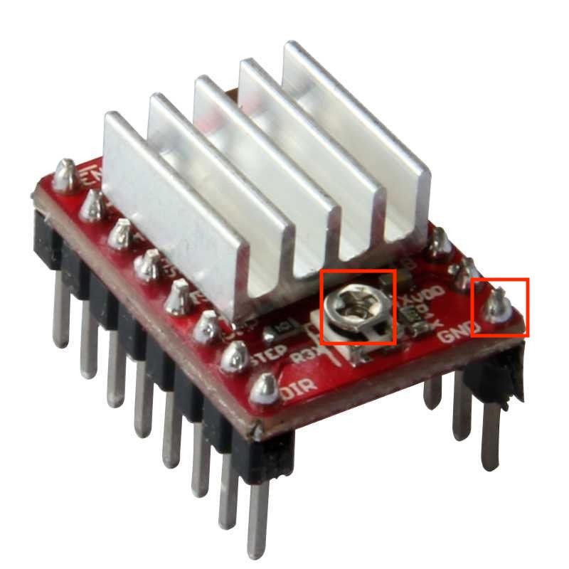

This is due a shortage of voltage on the 'z' driver on your motherboard. I had the same issue.
There is a little potmeter (philips screw) on the driver. You need to boost the voltage up to a least 0.8 or 1 volt.
You can easily measure this, just put your voltmeter between the GND and the potmeter on the driver.
Good luck!
