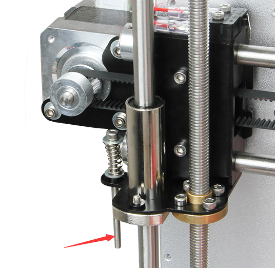

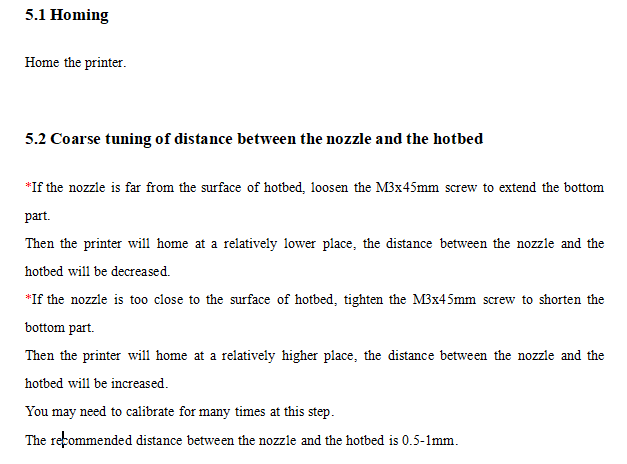

1, Have you homed it each time when you leveled the bed?
2, Check the Z offset or reburn the firmware

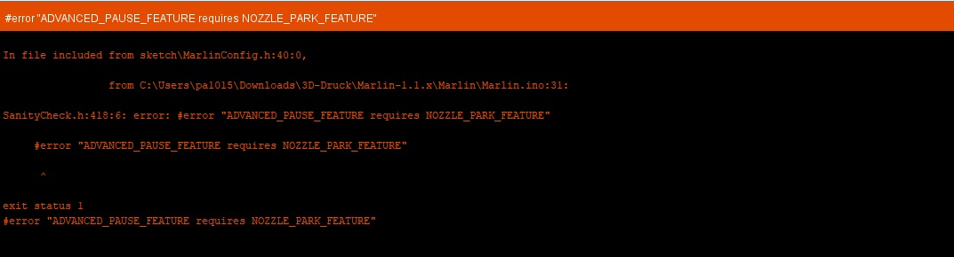

When compiling in Arduino 1.8.7 I get the error shown in the image. Should I enable the NOZZLE_PARK_FEATURE in the Configration.h?
Thx for your help.
Thx for your help.

I'm getting this error on arduino software version 1.8.7
U8glib.h: No such file or directory
