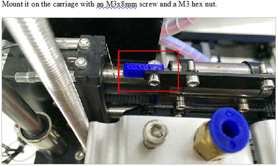

Most of the Part ID do not match my kit. I make corrections as I work but it takes more time so i wanted to confirm.
My kit has a metal extruder holder (X carriage) (M3) which is very different from the instructions. Fortunately, the Youtube videos (https://www.youtube.com/watch?v=RL2ELVk ... 3yLrUDpCZC) are a good match.
The is no mention in the instructions about 51A (endstop trigger). I am guessing it goes on the extruder holder (X carriage).

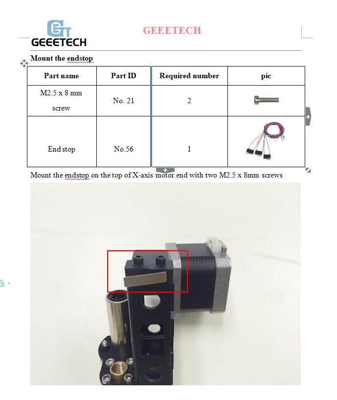

The endstop(of X-axis) is mounted on the top of the X-axis motor end.
It is shown in the attached file, although this building instruction also needs to be updated, too.
But it's more clear than Wiki.
- Pro C building_instruction.rar
- (19.89 MiB) Downloaded 531 times
- 3.jpg (38.63 KiB) Viewed 10970 times

That is for 56 (endstop) but I was inquiring about 51A (endstop trigger). Fortunately, this intruction file you posted does confirm my guess on page 51. Thanks for the file and your help!
- 51A_Location.jpg (41.84 KiB) Viewed 10914 times
