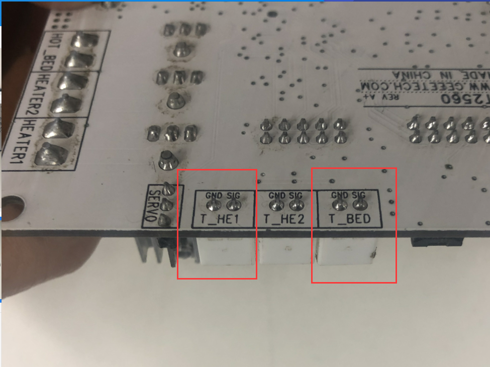

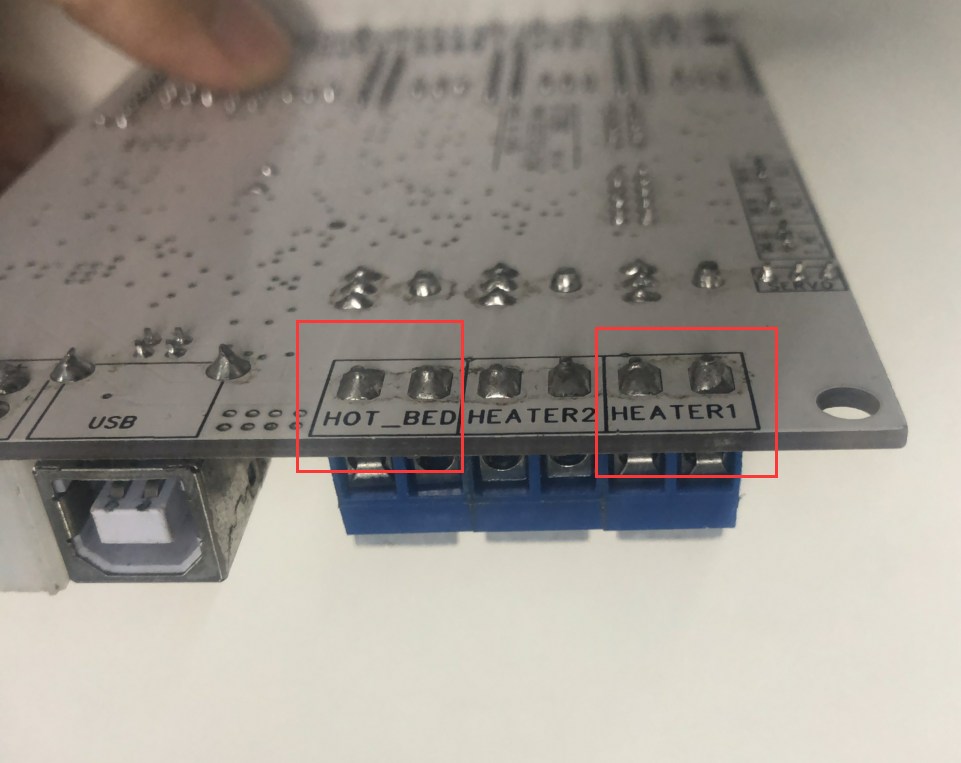

i tested but i have a problem with Repetier Host, the button bed controls the temperature extruder, it's inversed.

Re: New mother card works but problem Z axis
[quote=regisregis post_id=84322 time=1527329643 user_id=65381]
Thanks,
You can show the correct connection with mother card about temperature control ?
Thanks
[/quote]
I think you can check the heating or thermistors wirings of hotbed and hotend, swap them to have a try.
Thanks,
Thanks
[/quote]
