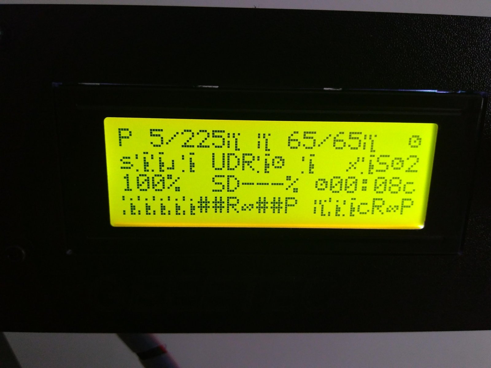

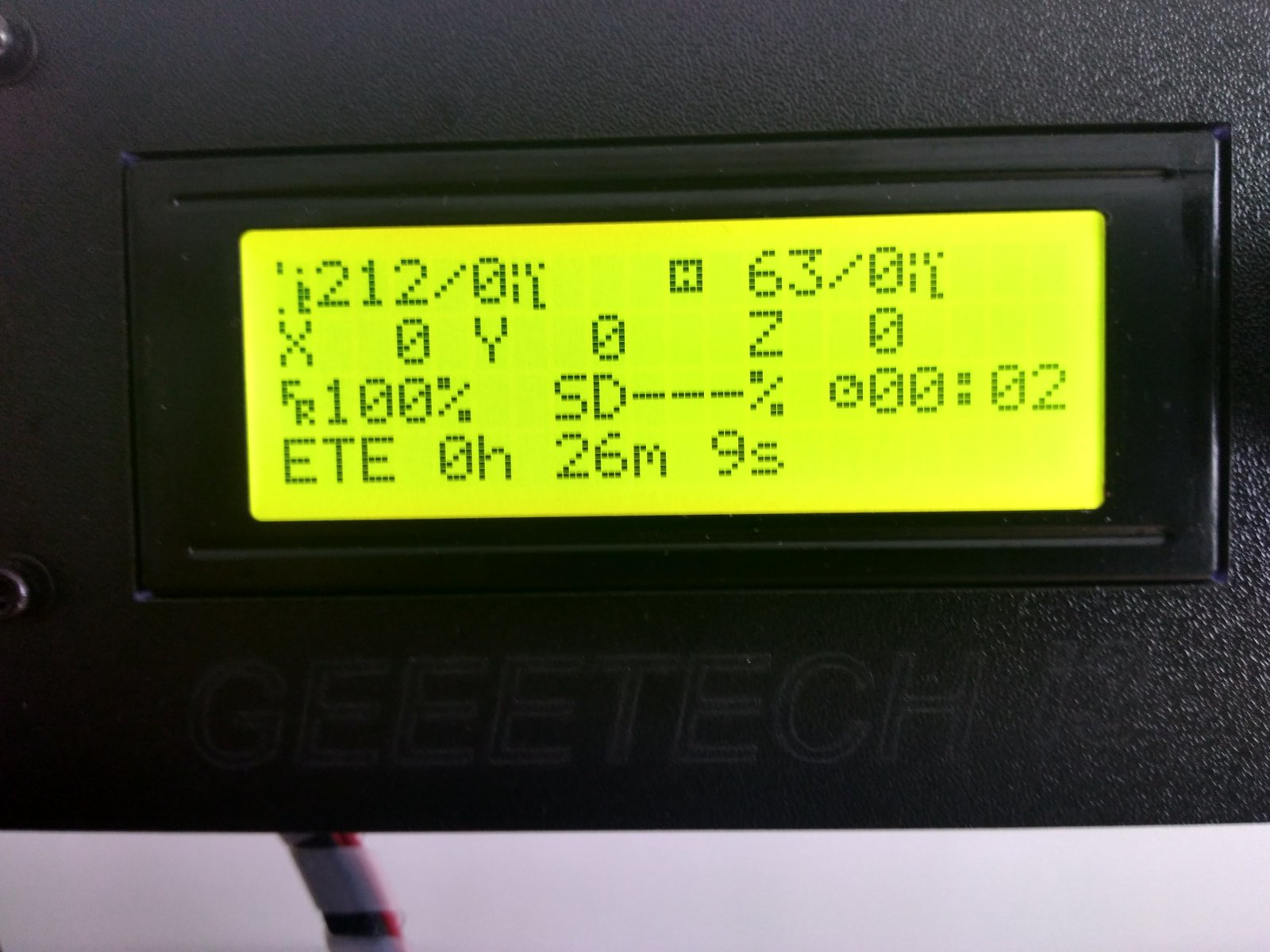

The print was estimated to take 6 hours. When I came into the room after about 1 hour, the printer was moving always on the same line back and forth, without extruding material. Parallel to that, the display showed weird signs (see attachments).
Now, the error continues: If I start to print, let´s say a cube, on e.g. the right corner of the cube, the printer underextrudes and starts clicking.
I changed the nozzle, but it did not help. If I go to manual control and let the extruder move, it extrudes without problems. The rest of the model is printed ok, but always at some certain points, the extruder starts clicking again. Parallel to that, the display either shows complete bullsh* or changes the ° and temperature signs to some weird symbols.

Display showing weird symbols + extruding problems
- weird symbols 2.jpg (166.81 KiB) Viewed 8284 times
- weird symbols 1.jpg (240 KiB) Viewed 8284 times

Returning to the clutter on the display ;-)
This could be a more serious matter with regard to equipment and electromagnetic interference.
First of all, the display, or rather its built-in controller, is not adapted to connect such long cables. So it can work, but it doesn't have to work under such conditions.

Re: Display showing weird symbols + extruding problems
Thank you for your offer. I checked the local eletronic store and finally found the correct connector, I think. I initially searched for connectors with pin distance 2,54 mm, but it had actually been 2,0 mm, that´s why I did not find the right ones.
The garbage on the display has disappeared since I repaired the connector of the extruder. Do you think it is possible, that because of the defect connector (occasionally connecting and disconnecting), additional electromagnetic signals were emitted that interfered with the display?
This is very much possible.
