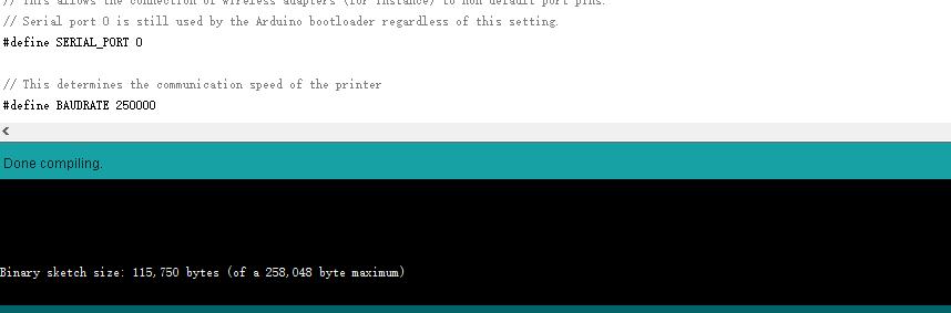

The firmware in the forum can be compiled without bugs, try with Arduino V1.0.1.
Edit directly in this firmware. Not sure that whether Pro W can use this sensor or not...Google some information like: https://3dprint.wiki/reprap/anet/a8/imp ... edleveling

I had the same issue. I used 1.01 and all worked well.
