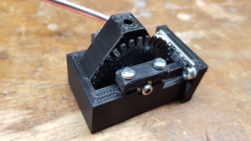

filament detector is just a regular switch like Xmin or Ymin but with led. It doesn't consume alot of power

I'm fairly new to Marlin and the add-ons it offers, So I found myself here via google to setup a simple filament sensor on my GT2560 Rev A i3 Pro B
I started from a virgin version of Marlin and have so far added auto level bed sensor (using an SN04 sensor)
I'm now taking the z-axis micro-switch and making it into the filament sensor.
So... I've not set my motherboard correctly in Marlin (only just realised this) so I've now figured out that I needed to make changes to the Ultimaker_pins file and not the GT2650reva one.
anyway...
I'm running V1.1.8 and have changed the following -
So in the ultimaker_pins file, In the limit switches section...
Code: Select all
#define X_MAX_PIN          -1  // Changed to allow allocation for FIL_RUNOUT_PIN - was 24
and then added the following line at the bottom of that section
Code: Select all
#define FIL_RUNOUT_PIN     24  // Changed - added line to re-assign pin 24 for filament sensor
In the configuration.h
find this line and un-comment it
Code: Select all
#define FILAMENT_RUNOUT_SENSOR  //  Changed - was commented out - enabled for sensor
In the Configuration_adv.h
find these lines and un-comment them
Code: Select all
      #define NOZZLE_PARK_FEATURE  // Changed - was commented out - enabled for M600 command
      #define ADVANCED_PAUSE_FEATURE  //  Changed was commented out - enabled to support M600 for filament sensor and filament change.
Complied and uploaded ok.
After checking the status of the filament runout sensor using M119, it showed as triggered and open ok.
But it wouldnt print, it just kept looping the M600 filament change routine.
After a bit of double checking, all I needed to change was to
Code: Select all
#define FIL_RUNOUT_INVERTING true // Changed was false - Switch connected as NC when filament is present and open when its out.
Hope that helps people....
