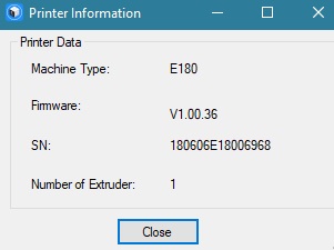

I’ve recently updated my E180 firmware using the provided Toolkit. The printer status now reports 1.29.36 however EasyPrint3d still reports v1.00.36

@NathanZ Can you post your screenshot about wrong version information in here?

Screenshot attached

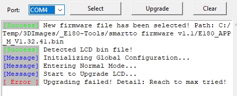

No dice - selected E180_App_M_V1.32.41.bin and I get an error related to updating the LCD!
I've removed the screen firmware from the same folder as the mainboard but same result.

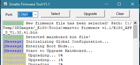

On a whim I decided to try the E180_APP_S_V1.32.41.bin file. Lo and behold it was detected as a mainboard file!
The upgrade succeeded, but still cannot apply the M file for the LCD - same error as previous post.
The printer now reports v1.29.41 (not 1.32.41 OR 1.29.36)
EasyPrint3d reports - blank -

@NathanZ It seems like you didn't insert TF card into printer.
Re: Firmware upgrade prevents saving of leveling settings (v1.26.36)
No - because why would you? It's supposedly for transferring print models not firmware updates. So all the toolkit does it transfer the bin files to the TF card which are then loaded on boot?
Update works with card in slot - perhaps some clear and documented firmware update instructions could be produced and included in the user manual, or even a clear post in the forums.
Also note the comment on the S and M files, toolkit reads M as for the screen and S as for mainboard.
