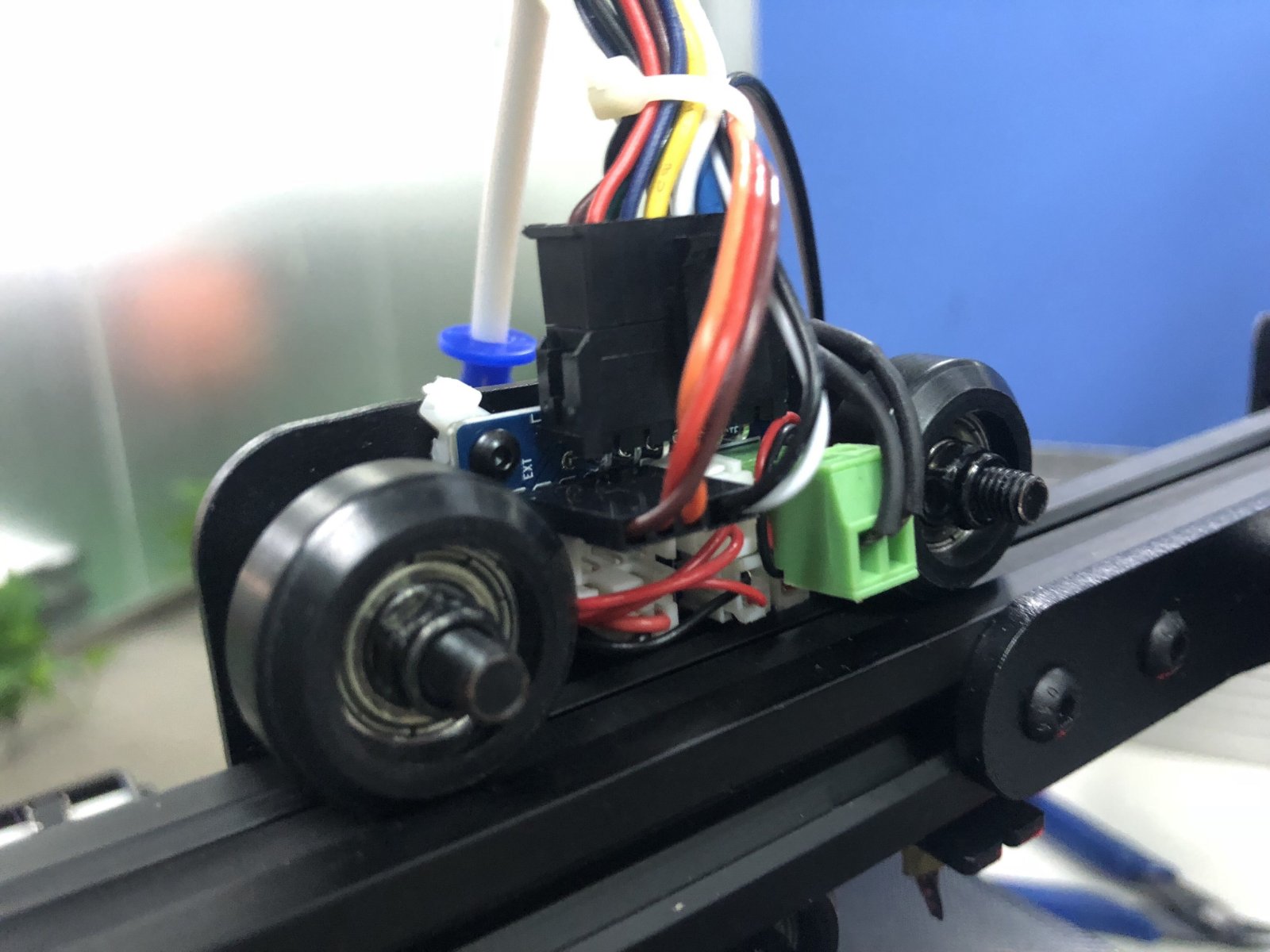

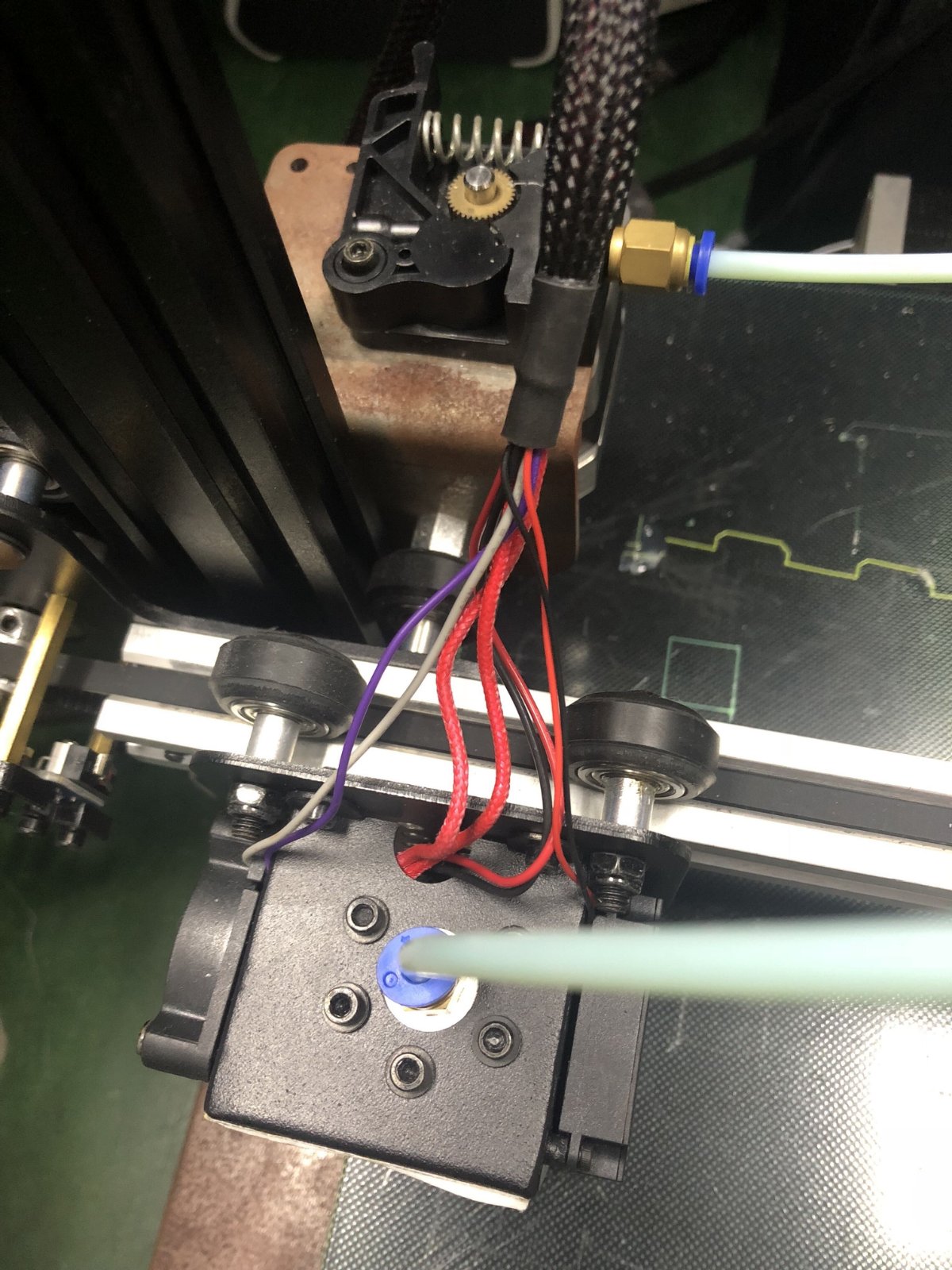

Can you tell me what kind of connection of the extruder that you have?
A or B?
Gingko
Posts: 230
Re: [URG] Nozzle heating problem
Post by Gingko »
I check your video again, it's A.
It's not easy to check the voltage. :oops:
smilingstone
Posts: 11
Joined: Fri Aug 10, 2018 6:44 pm
Contact:
Post by smilingstone »
Hi Gingko,
Yes, it seems A.
Hmm...
Thanks a lot anyway. I am keeping in touch with a guy (Lei) in Geeetech.
He also suggested me to check with multimeter.
I don't know what to do now, except replacing extruder....
