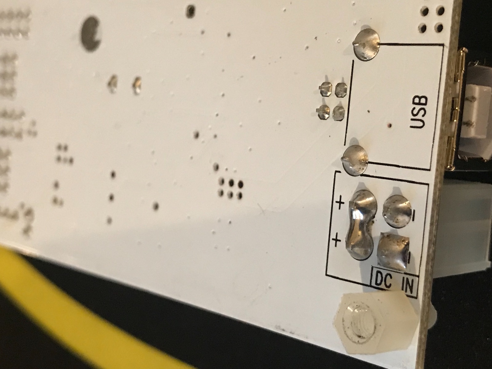

Having removed the control board, I've looked on the back and found that the soldering at the + points is merged. Surely this is part of the problem??
Would this also have caused the fan problem?

The fuse is worn or not properly seated
In my opinion, this soldering is not a problem.

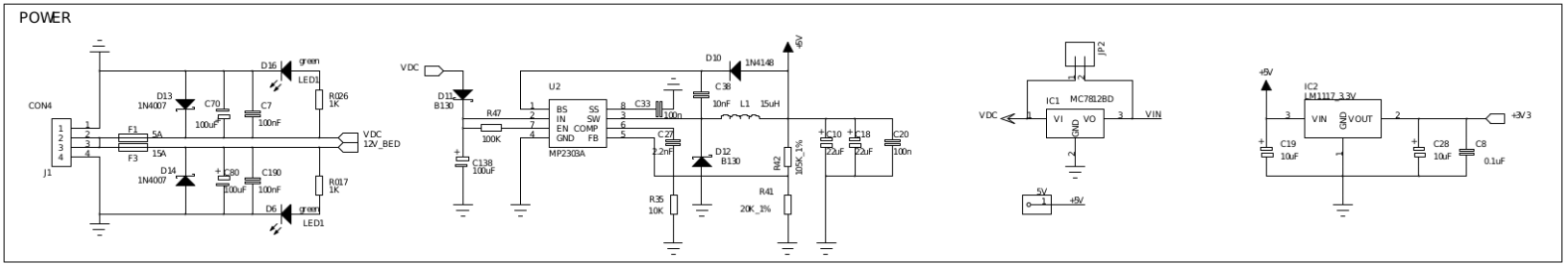

I have pasted a schematic diagram on the forum, look for it will be useful for you.

I will have to try find a replacement fuse. Your schematics are helpful. Thank you. I notice that your schematics show a 5a and 15a fuse. Mine are 10a and 15a so I’m assuming there is some variation. I need to replace the 15a.

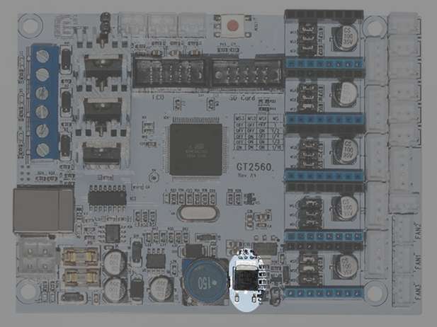

The fans use the VIN voltage for their operation.
This is the output voltage of the IC Positive Voltage Regulators 12VDC.
The controller is supplied with 12VDC voltage from the main power supply.
And we have the problem ready.
For correct operation, the stabilizer needs a higher voltage
Quote from the chip manufacturer's data sheet:
And this jumper JP2 is another misunderstanding.
As you well know, this type of multimeter will be indispensable in certain types of use.
Sold off the stabilizer, put the cap on the jumper and everything will work better than new. A stabilizer would be needed if you wanted to use a 24VDC mains adapter. But then there will be other inconveniences.

The schematic diagram comes from the manufacturer. The diagrams are officially available to users.MrJoatmon wrote: Tue Sep 04, 2018 4:29 am I will have to try find a replacement fuse. Your schematics are helpful. Thank you. I notice that your schematics show a 5a and 15a fuse. Mine are 10a and 15a so I’m assuming there is some variation. I need to replace the 15a.
So it will never work properly.A common ground is required between the input and the output voltages. The input voltage must remain typically 2.0 V above the output voltage even during the low point on the input ripple voltage.

Thanks for your help. It is appreciated.
Sorry for my ignorance but which part is the stabiliser that you refer to?
And to clarify, is this correct:
1) Replace blown fuse (littlefuse/nano fuse)
2) Desolder and remove the stabilizer
3) Use a jumper cap on JP2
If this is correct, I just need to know which part is the stabilizer! And then I need to order the right fuse from eBay.

First, use a multimeter to detect that the fuse is bad. Second, if the fuse is bad, change a good fuse, remove all 4988, and re-power. (A bad 4988 may cause such a fault)
