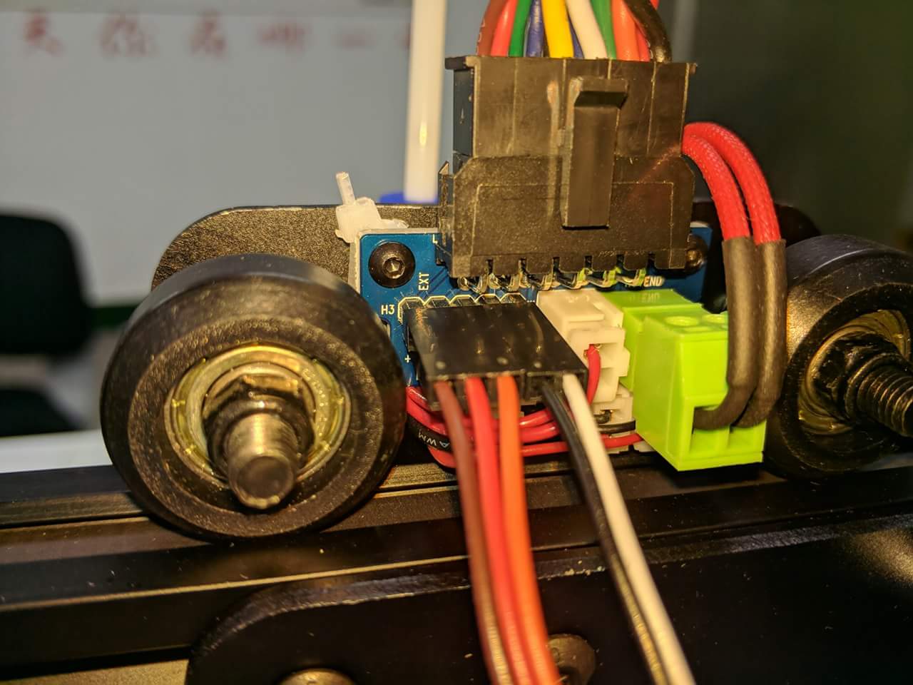

Does someone know where and how do I assemble an auto leveling sensor on the A10M and where to connect the cables(both of them)?

pinout is here but I am stuck on the Marlin side of things

HI all.
i have managed to get the 3d Touch working on the A10M.
here is how. (would appreciate a second look to ensure my instructions are accurate)
1. Install and Set the height of your BL/3d touch,
a. Home the Z axis
b Lower nozzle to the bed (if nozzle doesnt go to bed fully see section 10). And attach touch sensor to left hand side. Do not tighten yet. (you may have to CUT the sensor mounting screws shorter as they can interfere with access the screws to the printer)
c. Ensure the sensor pin is UP (if you have difficulty in keeping the sensor up plug it in as per step E)
d. Get a ruler or item around 2-3mm thick and slide it under the sensor. Important to measure the thickness of the item your using fo rStep 5.
e. Tighten the sensor up. And remove the ruler.
f. Plug the pins in the back as per photo above.
2. Go to your PC or MAC and download the firmware from https://github.com/Geeetech3D/Prusa_I3_3Dprinter. Extract the A10M folder out.
