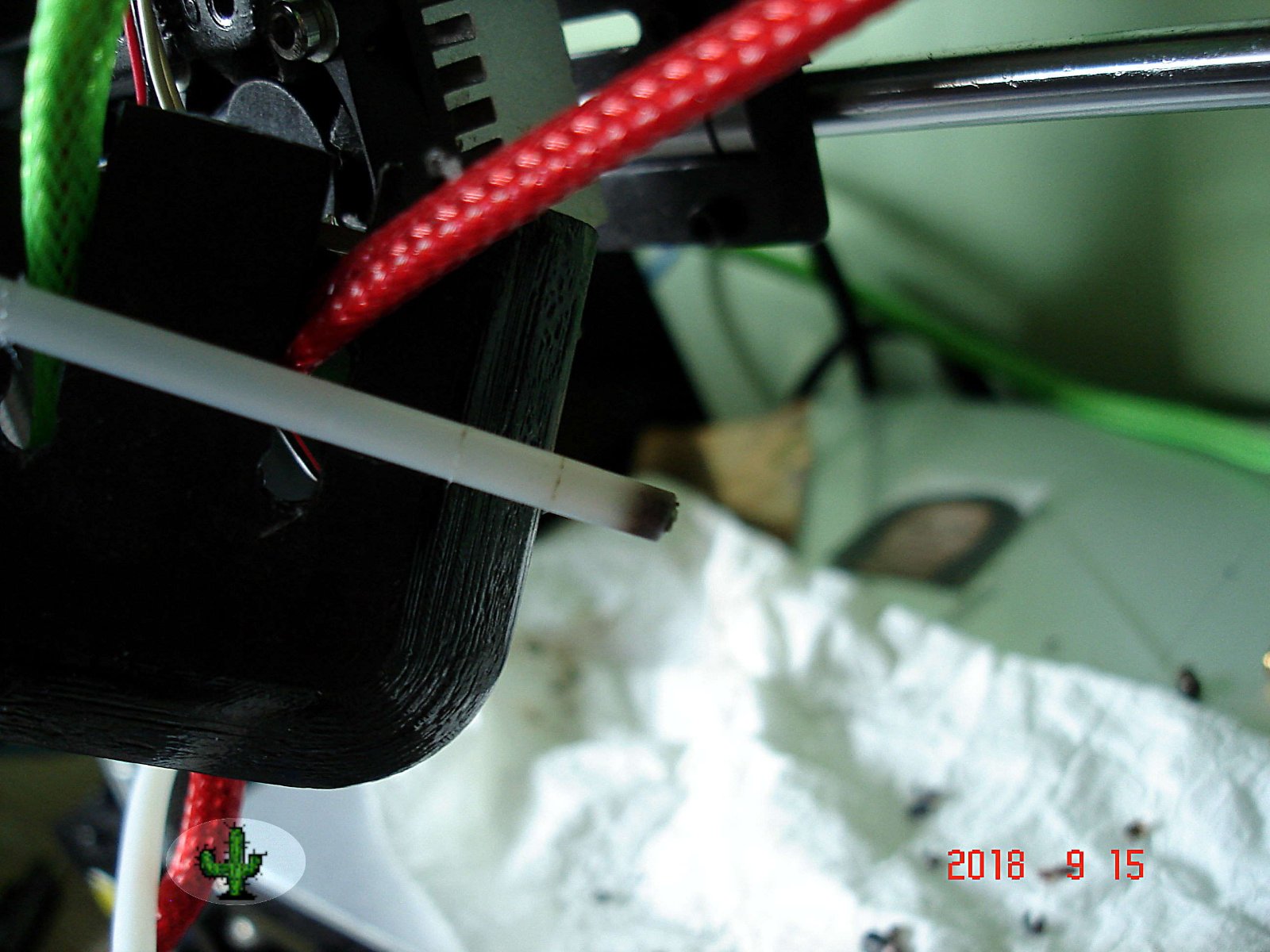

See what has happened to me. :?
This is the tip of the PTFE tube, removed from the head.
Geeetech filament, ABS only
