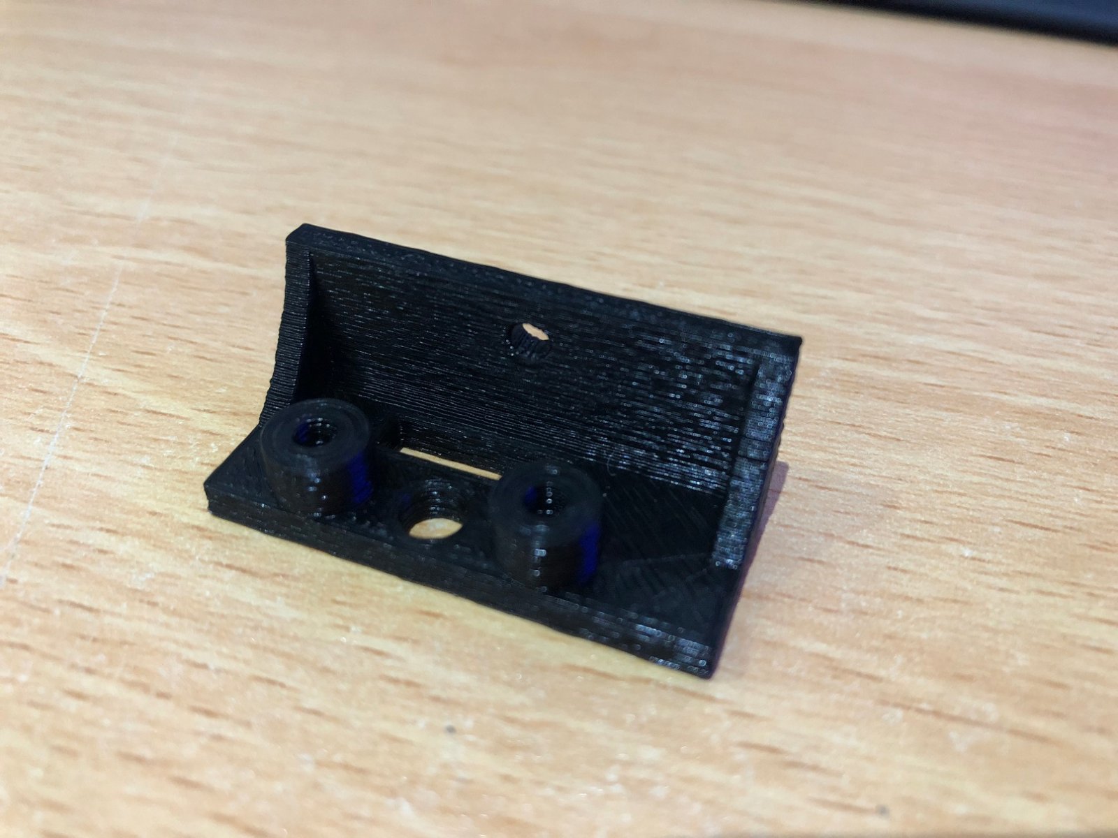

Out of interest how long should the Mount take to print (approx.) on the I3 Pro B with PLA.
I built my printer on Saturday, setup as well as I could and yesterday printed this model (which came out really poorly), it took 21 minutes to complete, so I think my Cura settings are all wrong.

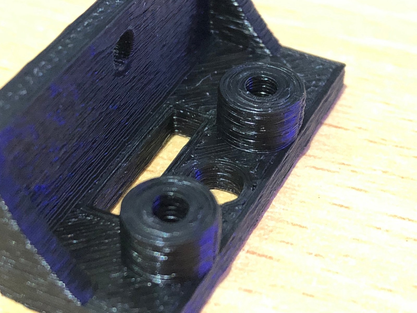

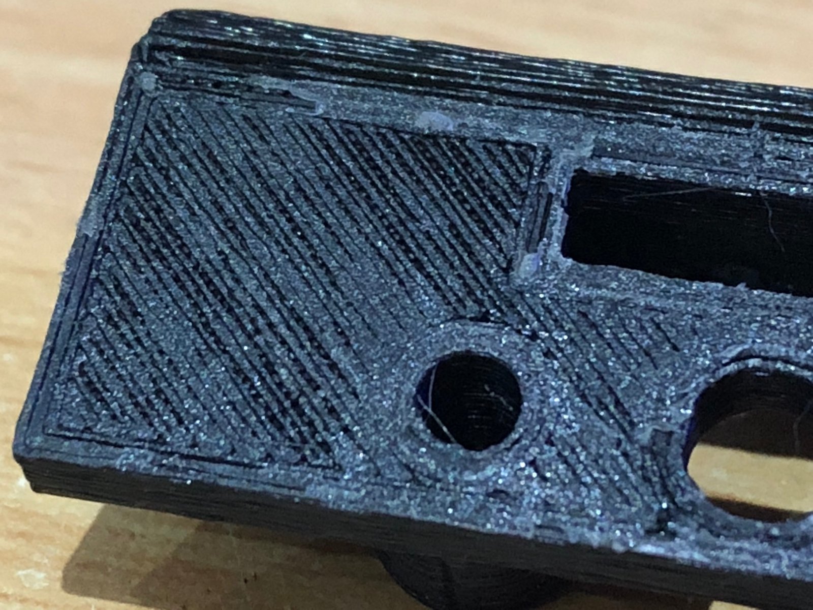

Ahhhh ok - I think I know where I am going wrong.
My Cura settings are sending a Z + 0.3mm (Up) command before printing, my head is already 0.2mm from the bed so before it starts to print the head is now 0.5mm away from the bed (way too far).
I am new to this but already seeing lots of misinformation out there, so am I correct is saying my head needs to be 0.2mm from the base if my nozzle is 0.4mm wide (half height of the nozzle width), or does the head need to be even close on layer number one ?
LittleTrader
Posts: 5
Joined: Tue Aug 28, 2018 7:15 pm
Re: 3D touch
Post by LittleTrader »
Got there in the end, 6 days to get my first print complete (and I picked the wrong version of the mount) so another attempt tomorrow.

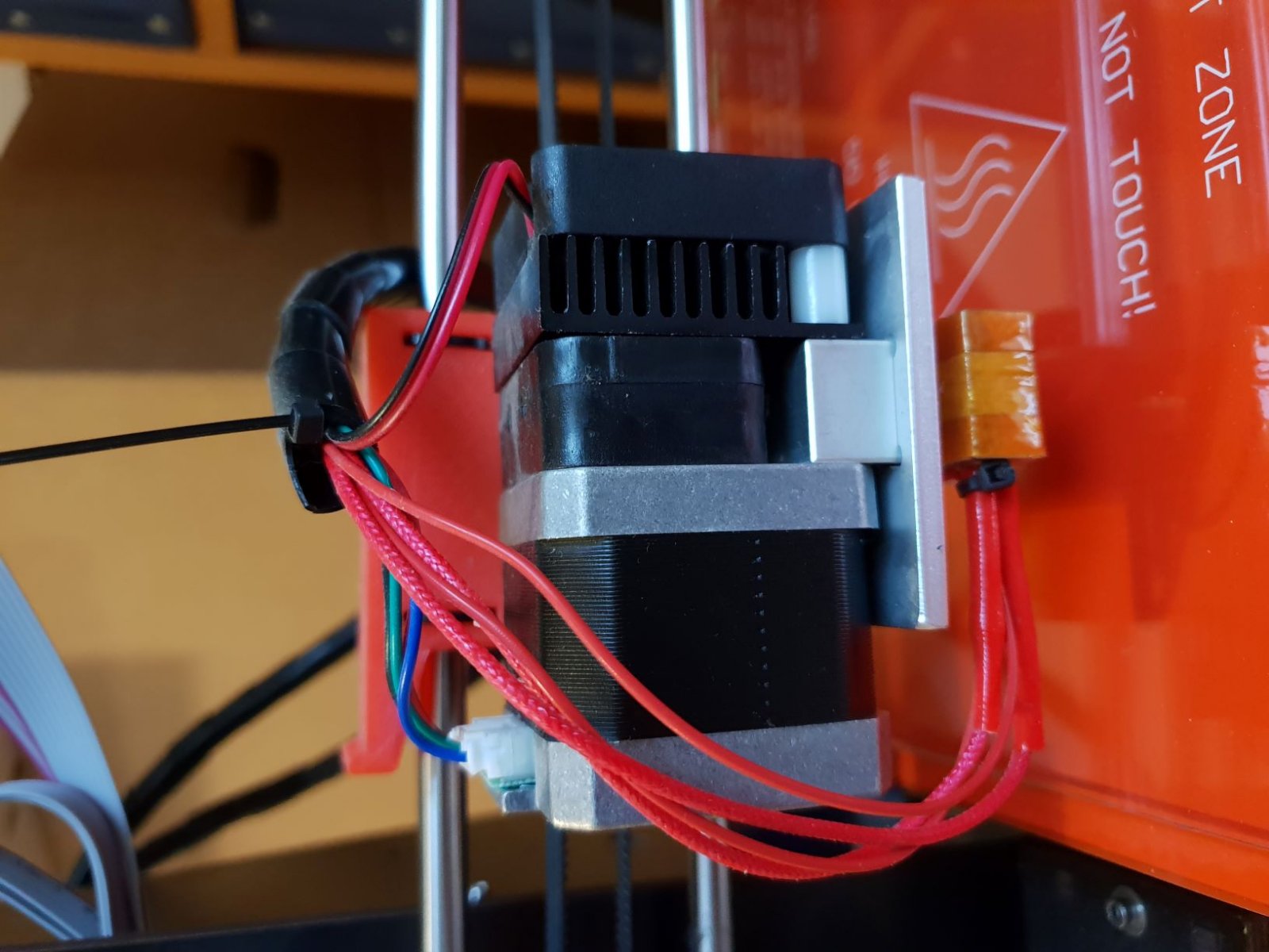

Sorry for the delay. Here's a picture of my extruder. Do I have to replace it?
Extruder 2.jpg (188.2 KiB) Viewed 11092 times
jzero42
Posts: 39
Joined: Wed Aug 29, 2018 4:45 am
Re: 3D touch
Post by jzero42 »
Your carriage looks different. It should be metallic and black? Search for geeetech i3 pro b on the net and you will see.
Yours doesn't have the mount point.
