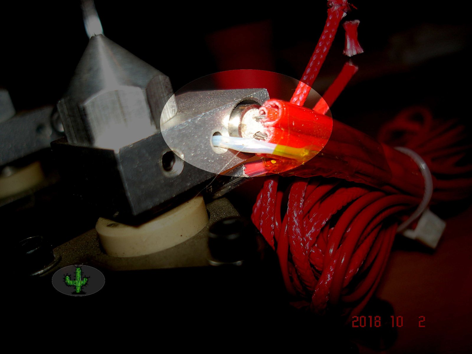

Hello,
so today I have received already spare heating element and in this case it seems to be OK, no connection between leads and housing. Seems that I really had just bad luck for two non compliant pieces. I have already the plastic distances for the board but first I will try to isolate the holes using plastic washers for TO220 transistors. If these fits in the holes, I would not need to drill larger holes in the frame. All I need now is to have some spare time to do it. Lots of other work these days
Regards
Michal

Hello,
Make a reclamation of the two previous exemplars.
If they are damaged they should be replaced immediately.
Head up, it will only be better.
Thanks to various problems you will get to know the equipment faster.
