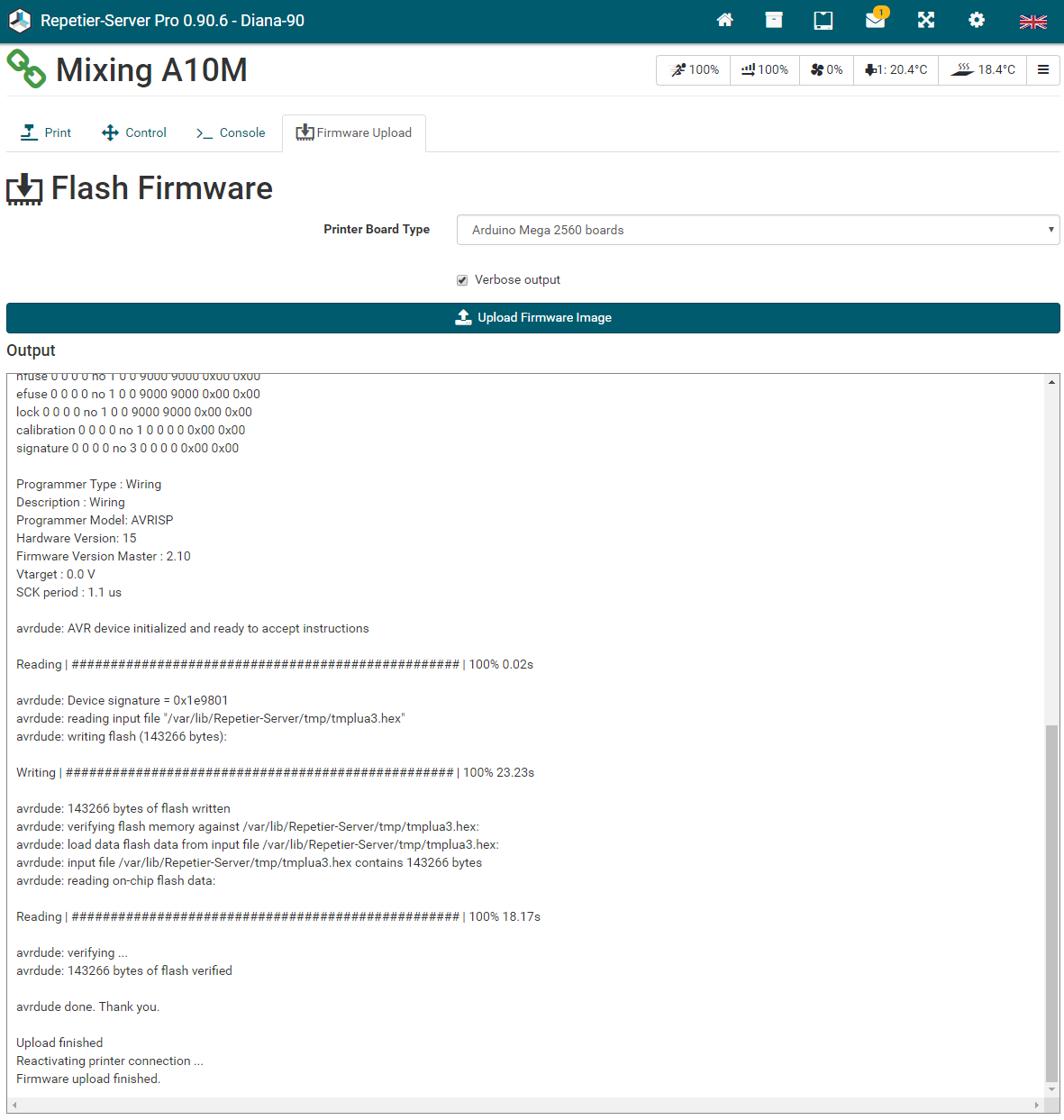

I use Arduino 1.8.5 but all my firmware uploads are going through Repetier Server (Running on Raspberry pi) and printers are connected to it.
Kind of remote printing, monitoring and control from another room :)
