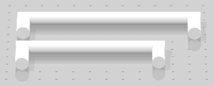

I have some experience in printing housings für electric circuits und other parts, but I also want to print parts for model railway. one Part are handles on locomotives. f.e. see attachment.
Are there any adivces, expierience how to do this ?

in Addition the problems I found since now:
the diameter of the handles should be 0.6 mm and the holders should be circular.
the primary question is who did already somthing like this, which material to use, which equipment (diameter of the nozzle, heating ..)
thanks for advice
thanks for advice
Re: printing parts for model railway
To print something with a .6mm diameter when the nozzle on the i3 Pro B is .3mm is pretty much impossible. You're also working at too fine a resolution to get anything meaningful as a print. From the i3 Pro B spec I've got: Layer resolution: 0.1-0.3mm, Positioning precision: 0.1 - 0.3mm, Hmmm... Not going to happen.
If your print is for the handles on the side of model steam locomotives I'd be inclined to make something out of copper wire.
