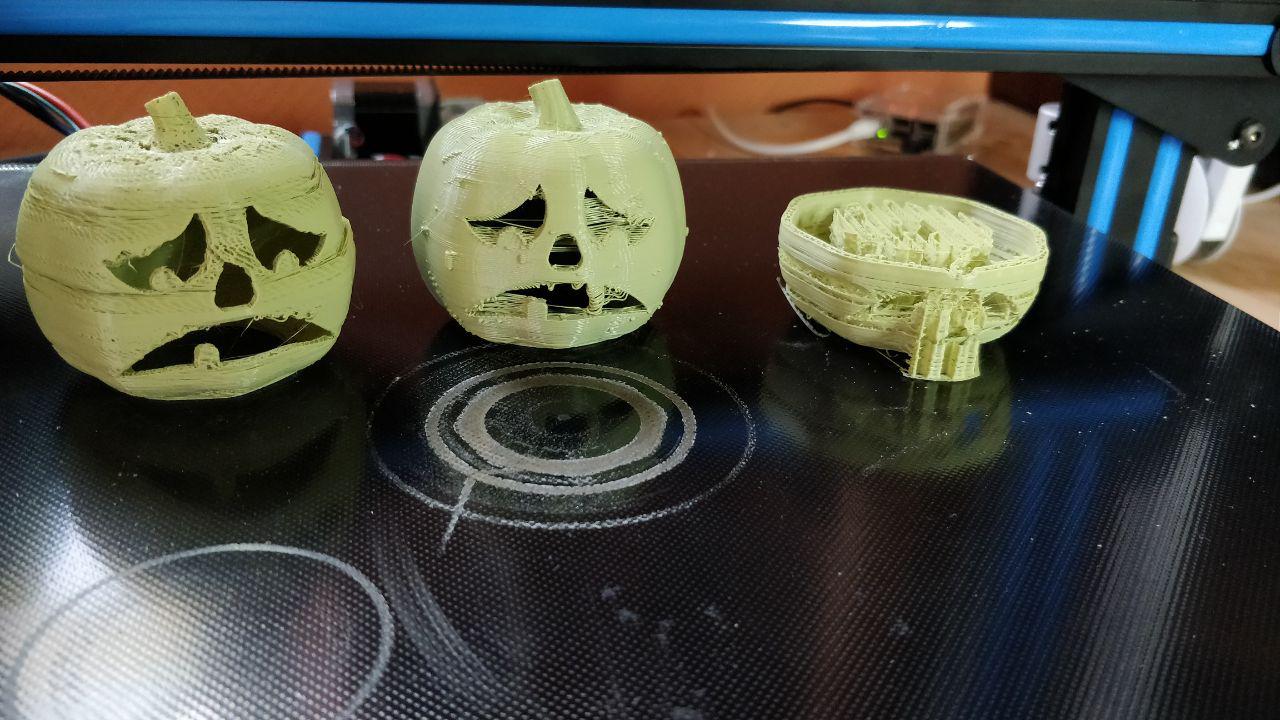

I am fighting since days with the leveling issue and it seeams that I am not allone.
If I manage to print, the Quality is very lousy.
See this pictue. Every object was printed with another slicer Software and completely different settings. From the left to the right:
Cura 3.5.0 , Simplyfy 3d , Geeetechs Easyprint3D.
Am I not new with 3d Printers, but I feel me like a new one.
What is your opinion? What could here wrong?
Thanks in advanced,
Mic

Re: A30 brandnew: Very poor print quality
Hello.
In my opinion it looks like a dosing problem. It's as if too little filament was given.
In any case, you must start to customize the Slicer options.
The printout in the middle looks the most beautiful. But the retraction parameters have to be additionally adjusted there.
Yes, it seeams so and I am wondering why? I have already raised up to 105%.
I printed the same spool of filament on another printer very well.
And why did the amount of the filament are to less also by using of geeetechs EasyPrint and set up to A30 Printer?
I think, they should now, what they are doing.
In the Moment I think I have issues with the Extrude Motor or something with the extruder. Odd - it s a brand new printer and instead of printing some nice objects I adjust, make tests and so on.
Maybe the nozzle temperatur is not correct?
Suddenly the Nozzle is clogged - during the print process. I changed two times the nozzle to a brand new.
The Extruder Motor clacks and i can see, how the pinion from the e-motor jumps back, because of to much friction.
If I press the Finger, the Motor runs, it is no preasure on the filament.
I remove the teflon and so on and see a big bulb. It is congested. But why.

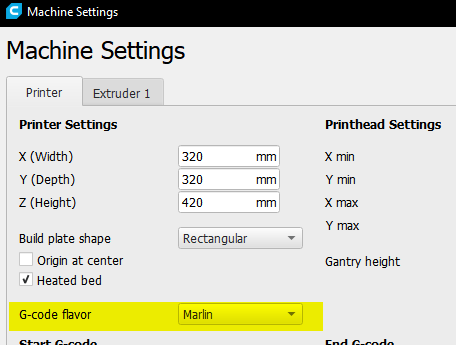

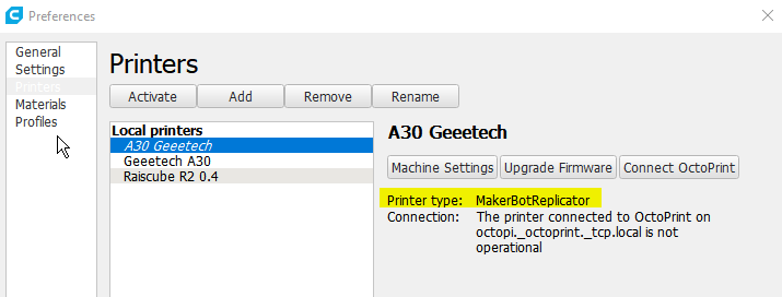

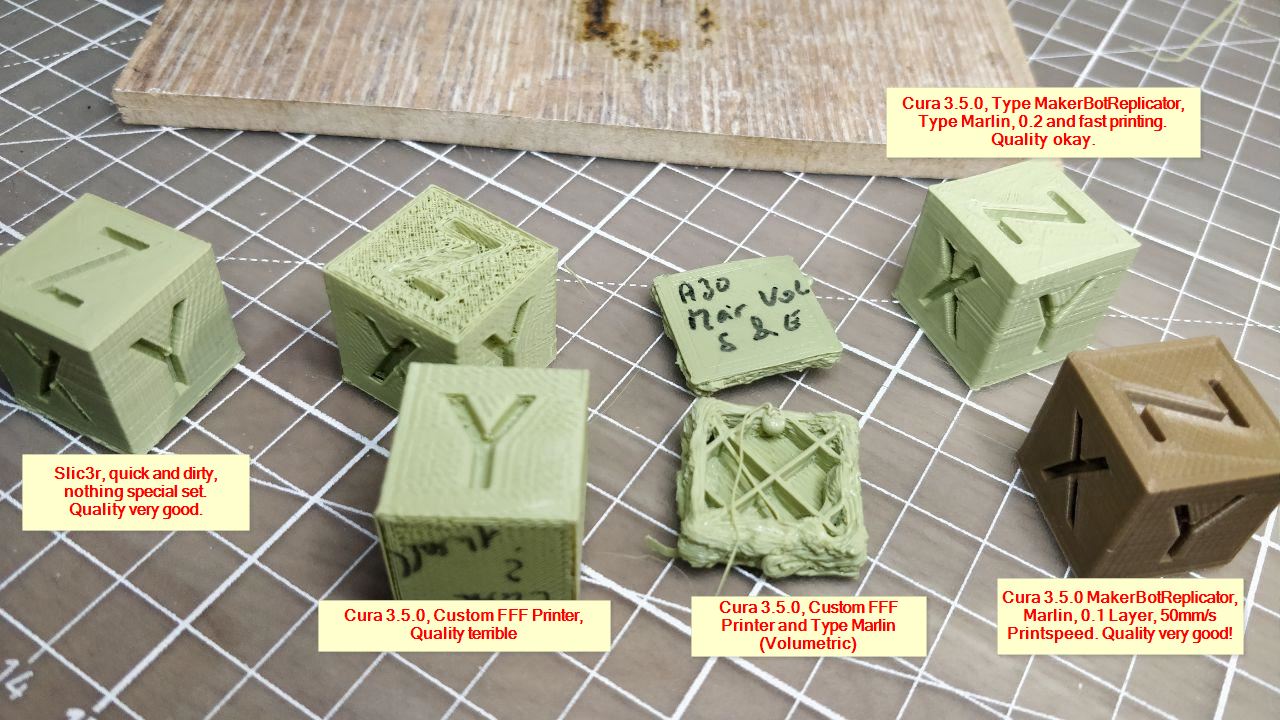

Apparently I found the Problem: Cura has to set to another Printertyp.
I looked to the less videos on youtube about cura and a30. As there shown I used the Custom FFF Printer. And this is in my case wrong, using >=3.5.0.
After using a "MakerBotReplicator" and GCode Flavor "Marlin" it is perfekt. Strange.
Also using the Marlin (Volumetric) Has an overflow of the amount of the Filament. Maybe it helps somebody. I wonder, if I the only one with this issue?
I had a very similar experience. Except instead of MakerBotReplicator I used the Printer Type Creality CR-10. The A30 & the CR-10 are very similar. Why did you choose the MarkerBotReplicator?
Was pure desperation. I've just successfully tested my Raisecube Profile, which was based on MakerBotReplicator. I have absolutely no idea, what would be the best. Since last Friday I spend tons of hours to get a useable printout.
