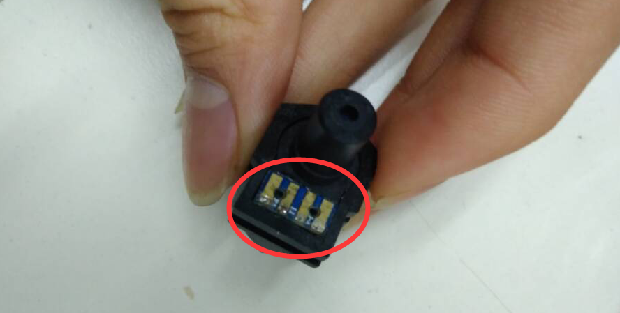

Extruder
1.Extruder does not work normally.(You need to check the temp of it is correct )
2.If you find the "Nozzle 0 temp",you can check the contact point of the nozzle.
You can use the soft cloth clean it
contact point.png (237.82 KiB) Viewed 24721 times

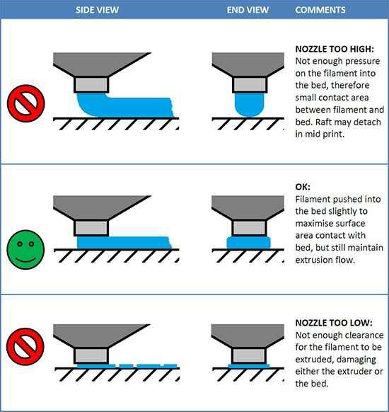

Level
1.Manual level

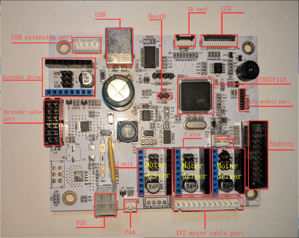

Source
1.Wires of the Mainboard: GTM32 MINIS
GTM32 MINI E180 wires.png (1.06 MiB) Viewed 24412 times
