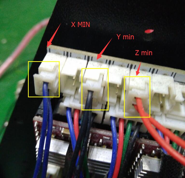

3.The motor can move at one direction only
1)Check the wires of the endstop
corrrect endstop.jpg (60.15 KiB) Viewed 29878 times
2)You need to check the endstop work or not
viewtopic.php?f=17&t=60927
3)Swap the a4988

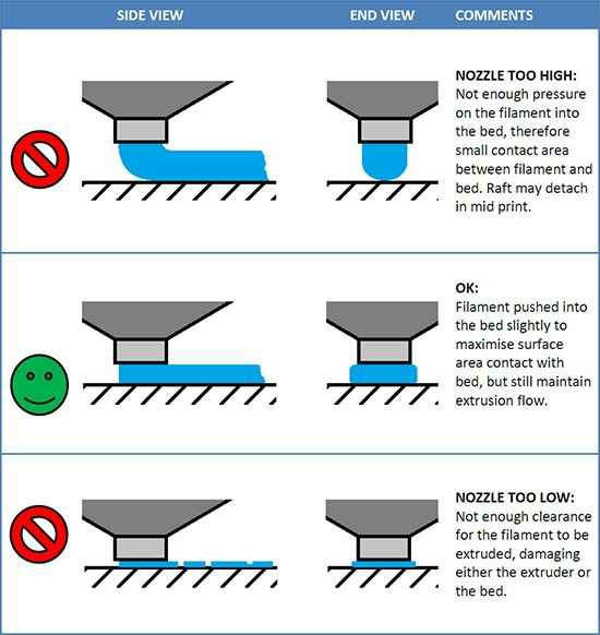

Level
1.Manual level

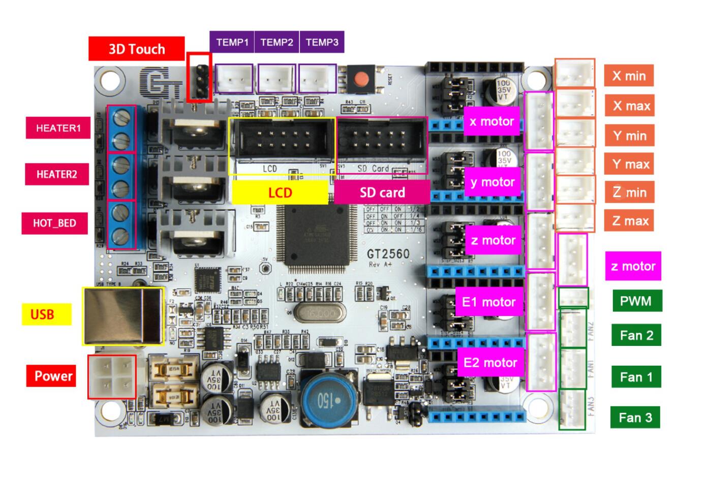

1.Information about the Mainboard: GT2560A/GT2560A+
http://www.geeetech.com/wiki/index.php/ ... GT2560A%2B
2.Schematic for GT2560 Rev A
http://www.geeetech.com/wiki/index.php/ ... 60_sch.pdf
3.Schematic for GT2560 Rev A+
http://www.geeetech.com/wiki/index.php/ ... evA%2B.pdf
4.The wires of GT2560A+
