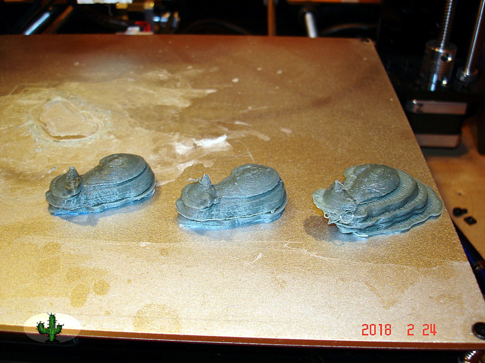

I understand that your printouts are damaged and look like this:
This is the shifting of layers.

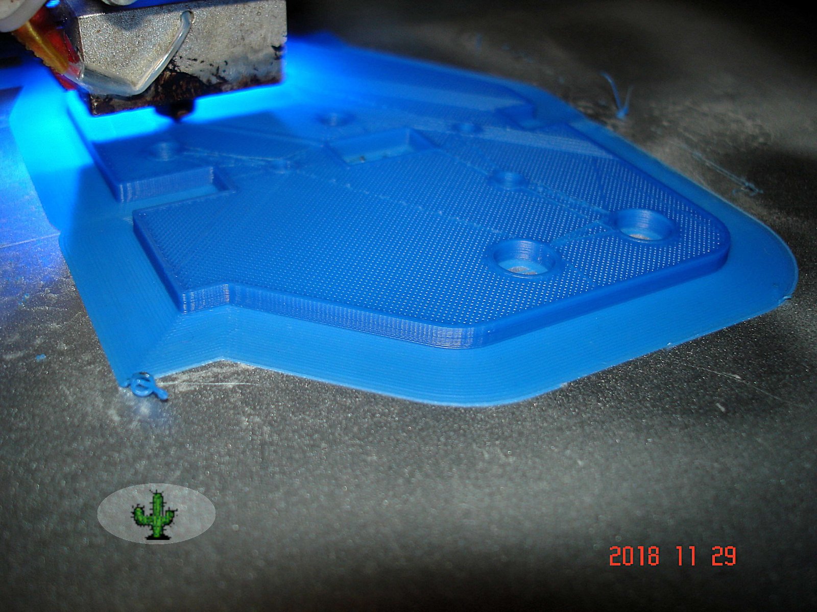

Now my prints look like this one:
You can clearly see the resulting printout and the regular structure of the filling. :D
This printer is a great design, but if you are new to the world of 3D printing you must be patient and gain some knowledge.

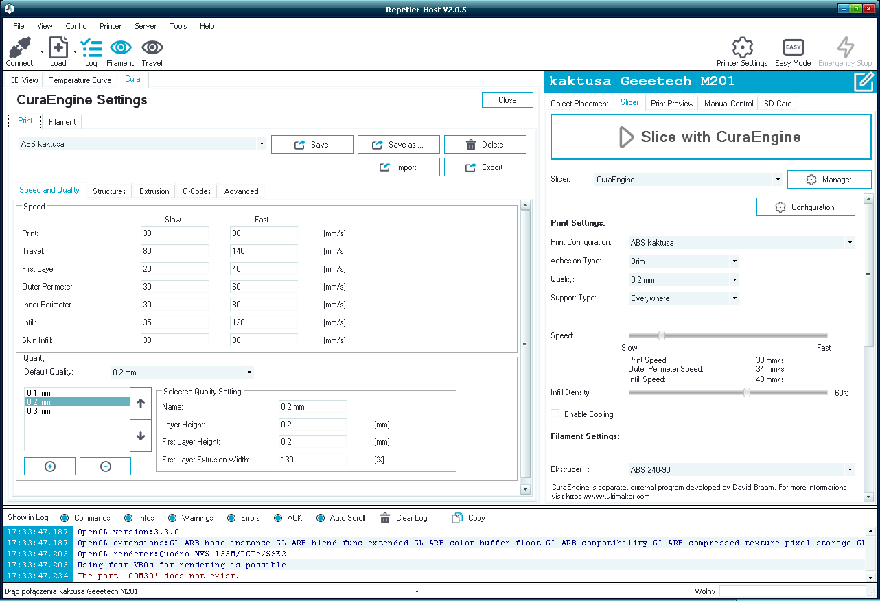

I have prepared an image for you with my print speed configuration (left side) and the current print speed setting (right side).
You can start using a printer with a minimum print speed setting. In some time (after several dozen hours of work) a little bit faster.
Let the mechanisms get through.
It's like with the engine in a new car. It must work to be reliable. :D
