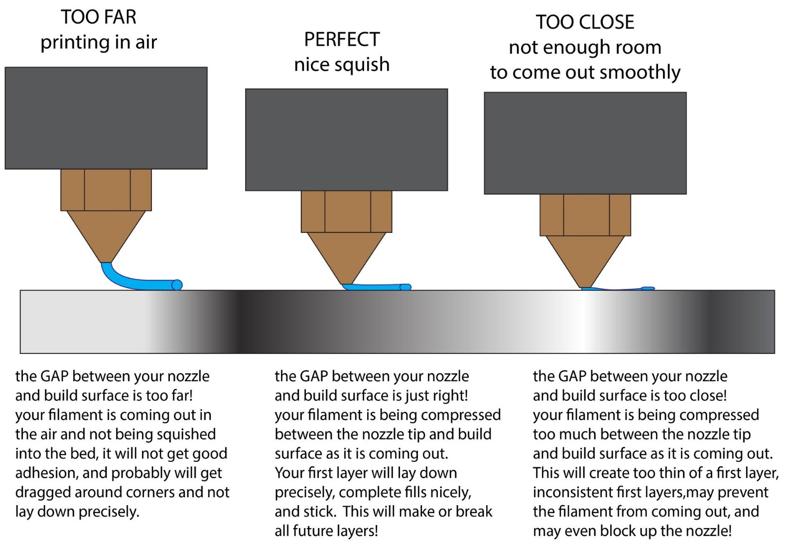

1, Temperature drops from 215/220 to 200, maybe you set the print temperature is different from the first layer temperature.
2, Nozzle looks too high that filament cannot be sticked to the bed.
nozzle height.jpg (200.13 KiB) Viewed 9460 times
