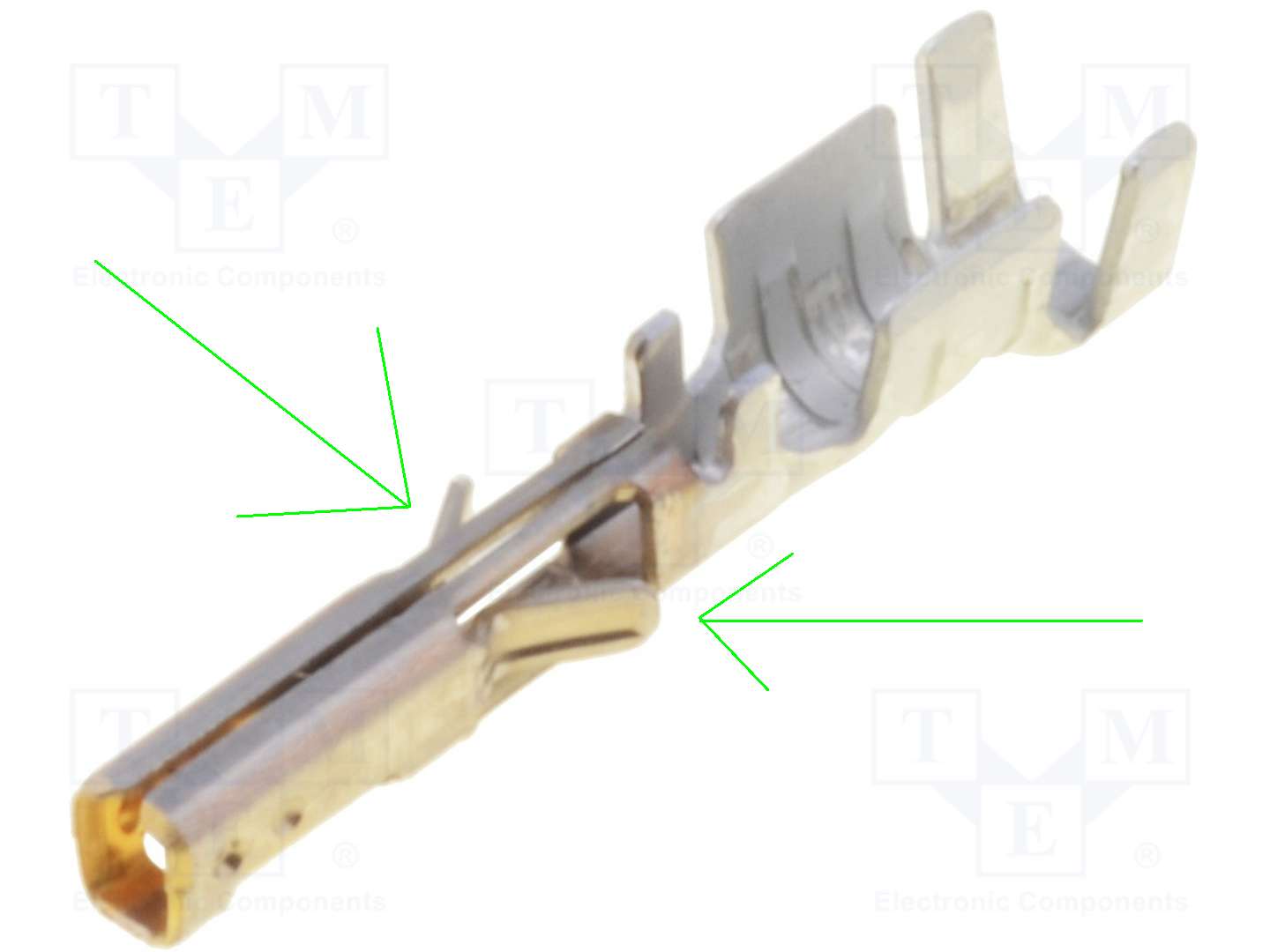

Carefully solder the place where the cable is connected to the pin.
Be careful that tin does not flood the female pins.
This operation will perfectly improve the quality of the contact in this place.
The cable should stop heating up.
To remove the pin from the plastic mount, find the latch and press it.
Example photo. ;)
Some types of pins have pawls on one side only.
