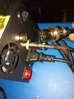

A30 bed connector.jpg (36.95 KiB) Viewed 5741 times
This is the connector to the bed which when connected, the control box goes off.

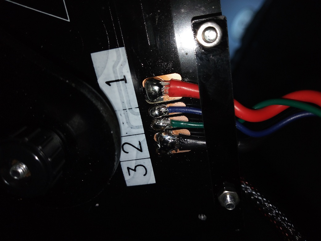

I just checked the male connector to the control box and this is how the wires were connected:
1 - No wire
2 - Black
3 - Blue
4 - Red
5 - No wire
G - Green
Is this in order?

Meanwhile, at the base of the heating bed, this is how the same wires are connected:
bed base.png (802.66 KiB) Viewed 5739 times
