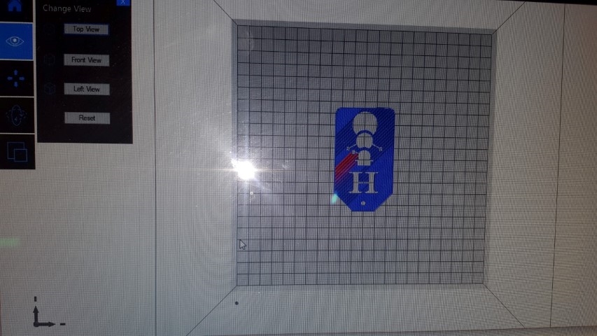

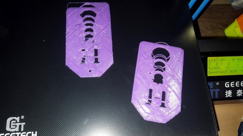

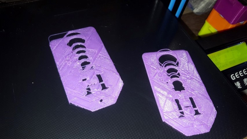

When I try to print when it gets to about the 3-4 layer it the next layer is printed nearl a centimeter towards the rear of the last layer..(see photos to understand better)
And the print is so messy it is useless(again see photos) if you look you will see a screen shot of what it should look like...

FOUND THE ISSUE
it was set at 250% material flow in the app!!!!!!!!!! how do you change this setting as everytime I open easyprint 3d (pc or android) it's reset to 250%

It looks like your pushing too much filament out. when it cools the nozzele drags and overloads the stepper motor and skipps steps.
