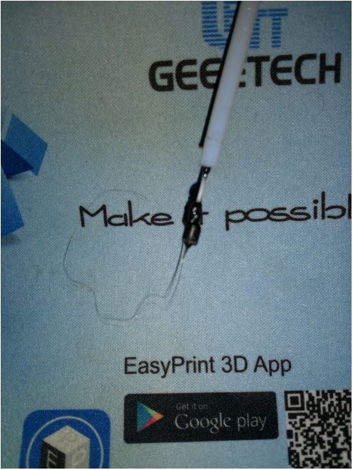

I've just finished mounting new extractor and with a great hope i just run a gcode to print an example, but it's worst then the last time, it just doesn't works, pla keeps melting in extractor!!!
What a loss of money and time with this product.
After a few test i just take the pla back off the extractor, this is how its look like.

Ofcourse it goes all the way down.
Re: Can't print a thing

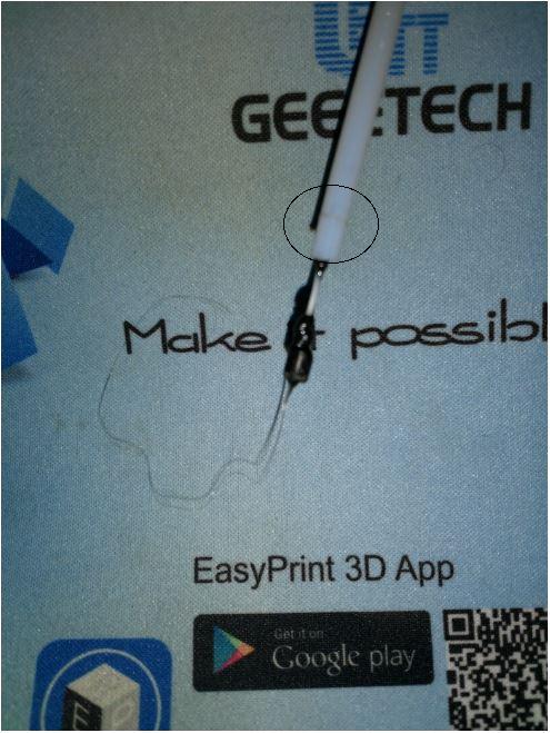

This little mark comes from extractor, i push it down untill it stops.

Hello.
Photography thoroughly reveals the problem of clogging.
The PTFE tube must be inserted so deep that it rests on the bottom of the duct.
You have to give attention to two things:
- that the duct for the PTFE tube is not dirty at the end
- that the tube does not slip out of the handle.

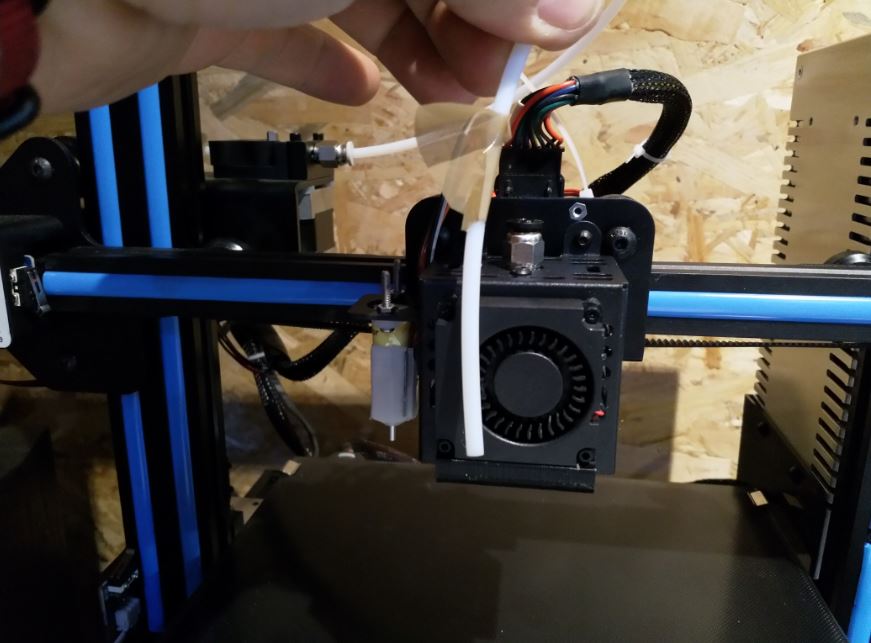

Hello,
This the longest PTFE tube goes into extractor, i can't push it any further.

Hello, I had the same troubles, try to print with higher nozzle temperature. My one is working well now but only with a nozzle temperature of 230°C for PLA
I'll try to do that, maybe higher temperature make this thing work.
Thanks.
