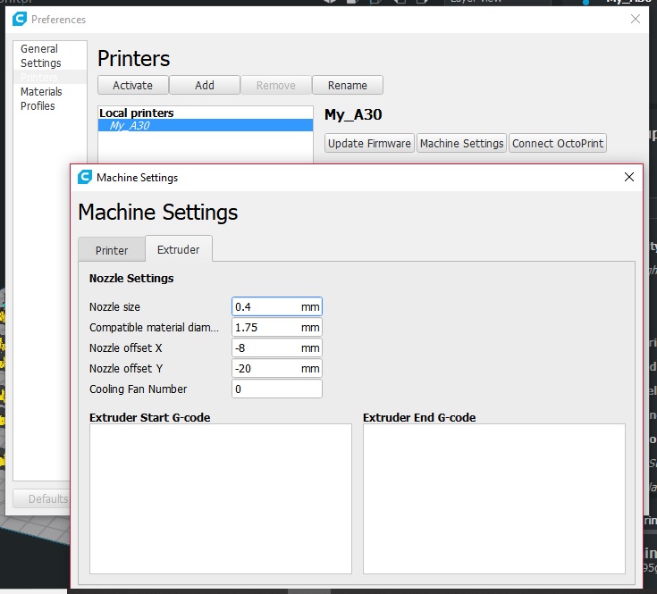

i use Cura for printing. in the Maschine Settings you can set up an Offset for your Nozzle. To get the Values: just move the Nozzle to your front left corner of the Plate(the real X0/Y0) than use that values for the offset with a minus in the Front. See attached picture.
The advantage is that you can move your nozzle out of bed. For purshing the nozzle. Maybe you have a simular setting in S3D.
It would be perfect if it would be possible to set that offset to in the Printer Software itself like in marlin. But maybe one day it is possible to use marlin as firmware.

I used an similarly setting in Slic3r PE but with the effect if I sliced an 320 x 320 frame (1 mm thickness), the slicer changed automatically the frame to 309 x 299. Means the slicer set the X0/Y0 position right (was on the Glas bed on the left front corner), but lowered the max X and max Y size about the offset. My offset was X-11/Y-21.
so in reality the max print size was X0/Y0 to X320-11/Y320-21
I checked this with different settings but got always the same results, either the 320x320 frame was fully on the glas bed ed but it was in reality smaller than 320mm x 320mm or the frame was really 320mm x 320 mmm but two sides was not on the glas bed. They was outside (left side / front side)

Re: Print is not centered...
p_rhodan wrote: Thu Jan 03, 2019 10:04 am Thank you for this information!
..... the slicer changed automatically the frame to 309 x 299. Means the slicer set the X0/Y0 position right (was on the Glas bed on the left front corner), but lowered the max X and max Y size about the offset. My offset was X-11/Y-21.
I was not the slicer how cut off your print it was the Printer itself.(I just had the same Issue, with Cura). Just try to go with you Nosel to the right Top Corner with the Touchscreen.
You need to download the Smartto Motor Tool with this you can increase the maximum Travel Range. For me I set it to X330 and Y345.
Now i can use the full Plate.
