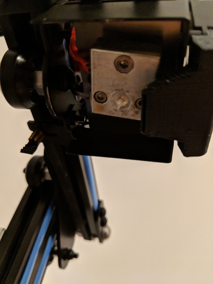

Damnit I managed to break the nozzle and bent the extruder block see attached picture :-(
Can anyone point me to the spare parts i need to order?
I also notized that the fan og the left site of the extruder was on all the time, is that normal?
Re: Extruder leaking?
Check the FAQ of the A10, then you need a new nozzle.

as for the fans inside the cage they are meant to be on all the time to keep the upper parts of the print head cool from the heater block.. you would not want your filament turning to mush before it hits the heater block and nozzle...
WhippingBoy
Posts: 27
Joined: Sun Nov 11, 2018 4:25 am
Post by WhippingBoy »
APLEES wrote: Sun Dec 30, 2018 8:20 am as for the fans inside the cage they are meant to be on all the time to keep the upper parts of the print head cool from the heater block.. you would not want your filament turning to mush before it hits the heater block and nozzle...
Aaaahh so its meant to be running at all time/always.
Good explanation thanks.

New printer head in place the new one is not leaking.
I will order a spare head for next time I have to replace the nozzle..
