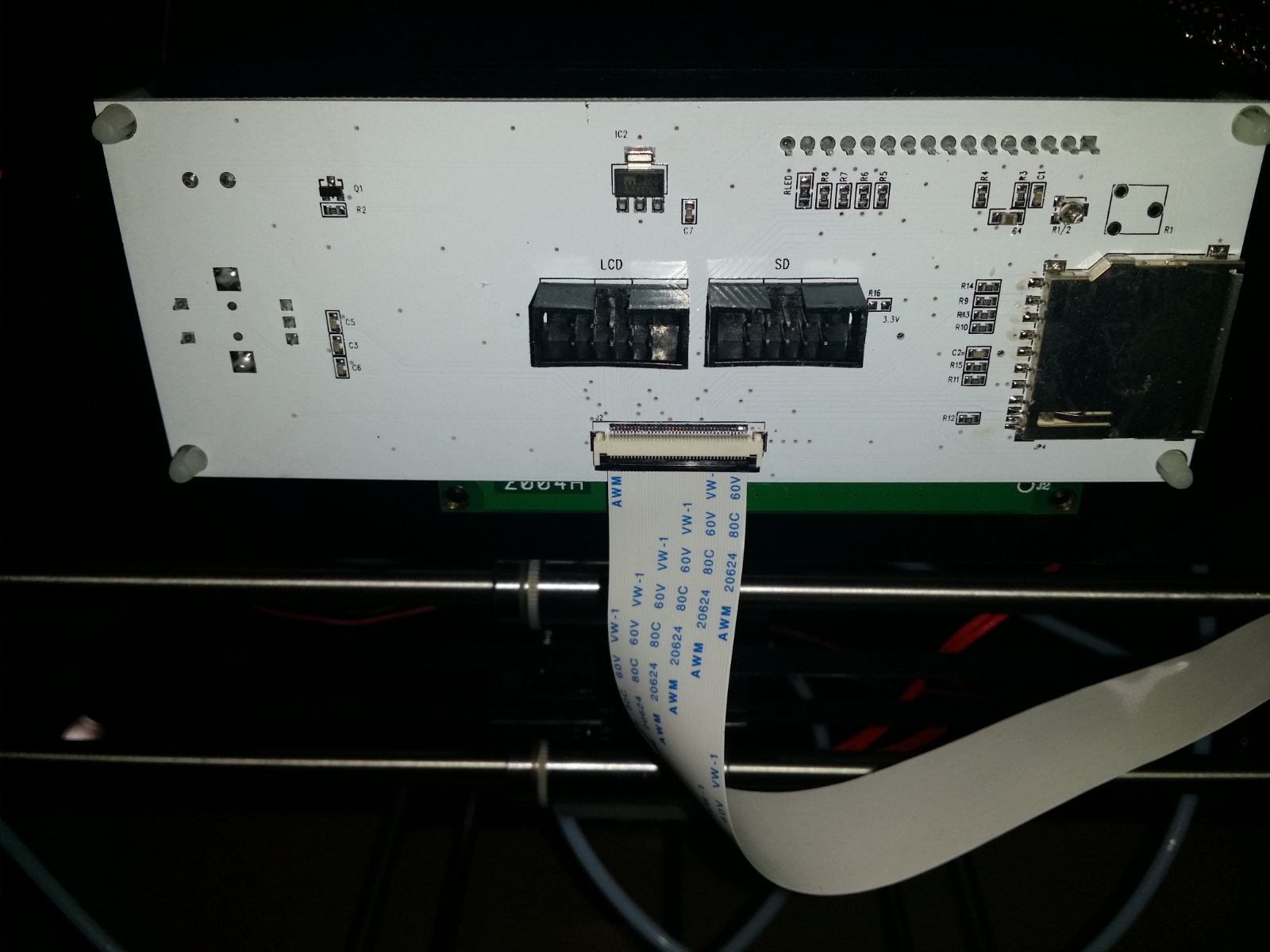

- where do i connect the extruders "o" &"1"
- 20181226_234947.jpg (373.19 KiB) Viewed 11638 times
- is the ribbon connected right?
- 20181226_235019.jpg (167.57 KiB) Viewed 11638 times

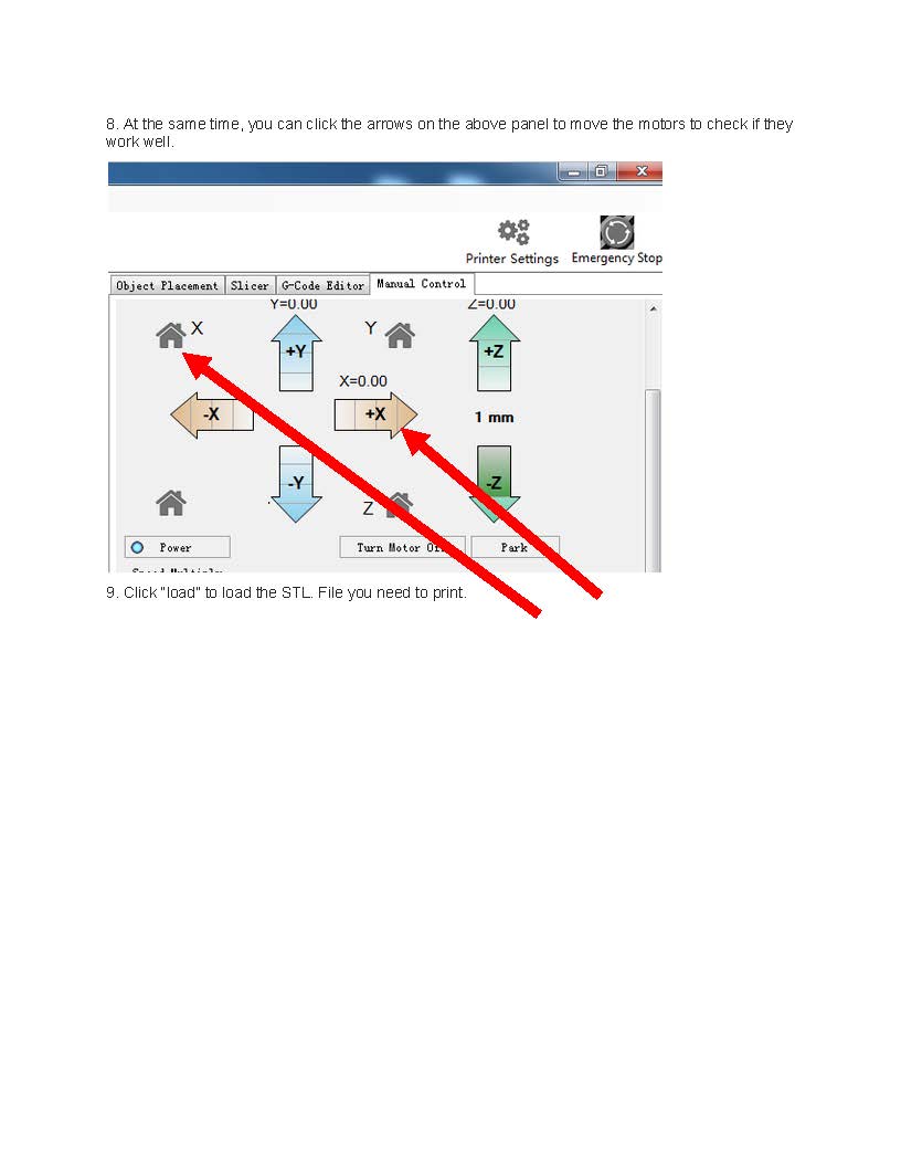

Step 8, moving the stepper motors independently. The "X": stepper motor will not rotate, i have the belt off, and loaded the repeitor program. Attached is the screen shot of the step i'm trying to using, to move the "X" stepper motor, used both the manual movement and the home.
i have moved the wires around and the motor is working, but it is not being told electrically to move.
What are the electro positive values required for each wire, and how do i adjust them (where is the POT)?

Re: M201 Assembly
Hi.
I understand that at the moment you have a problem with stepper motor control.
Have you checked the correct wiring and the order in which they are arranged in the plug is correct?
Have you already adjusted the stepper motor current in the stepstick module

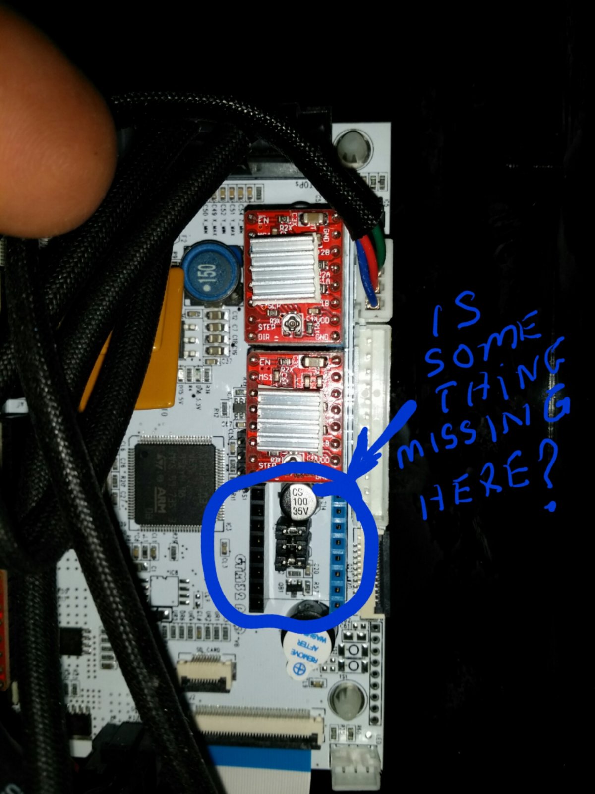

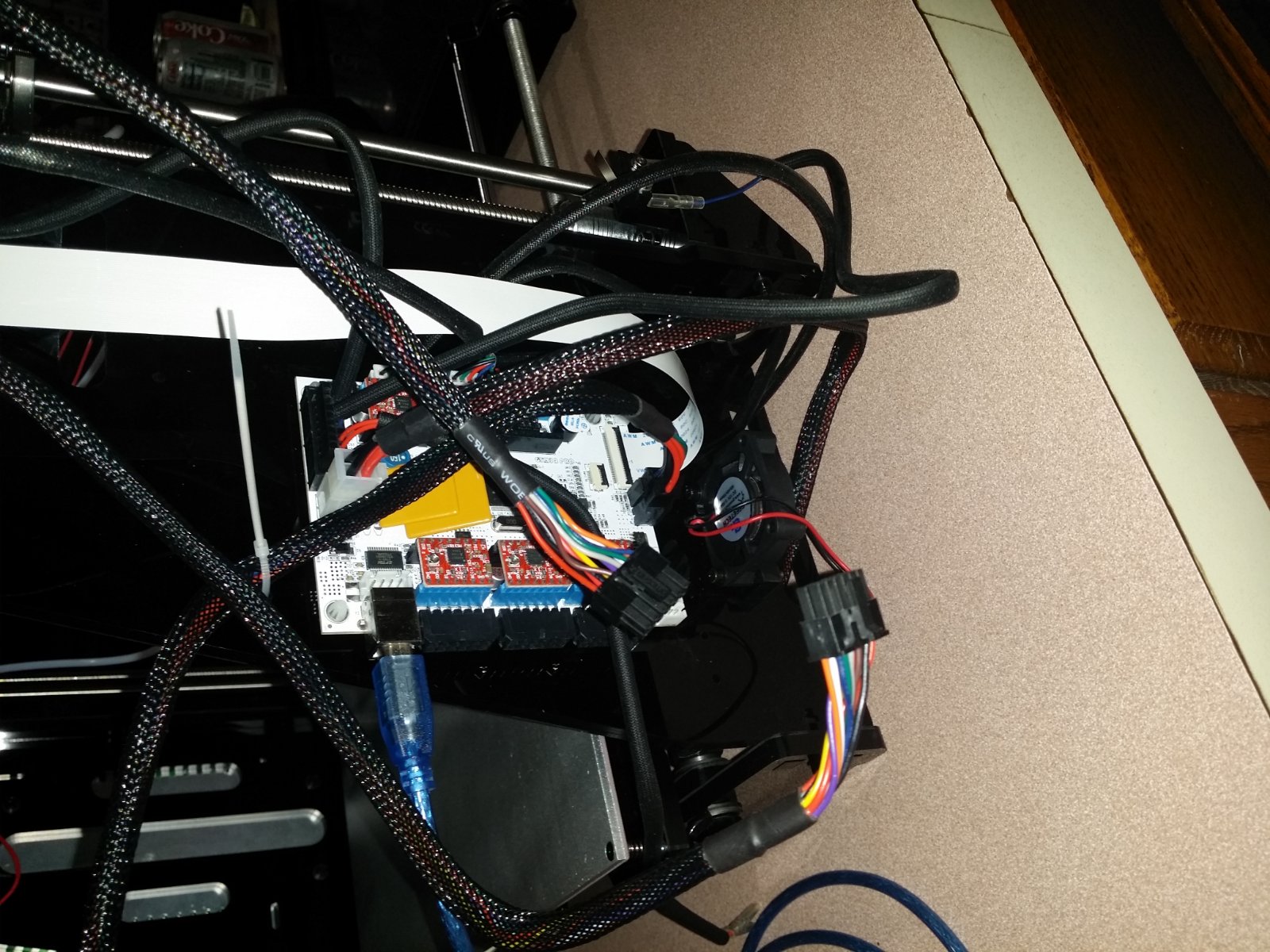

- are these wires correct??
- wires correct.jpg (213.37 KiB) Viewed 11487 times
- Is this missing a board??
- is this missing a board.jpg (207.8 KiB) Viewed 11487 times
Re: M201 Assembly
Hi.
I've already liked you.
The information you need is available on the forum.
I always encourage everyone to explore this abundant reading. You can find out a lot.
But since you have made some effort, so I will be happy to help you and I will devote some of my time to you.
When I built my printer, wires were crossed in one bundle. Of course I compared them with others. That's why I detected someone's mistake.
One day my friend from the forum (Mat), who also has M201, had a big problem, because the socket in the controller board was badly soldered. It took some time before we came up with it.
It was then that the subject was created: The sequence of wires in the stepper motor connector
Problem number two.
Adjusting the stepper motor current in the stepstick module: Turning up current - A4988
You can choose the values experimentally, so that the mechanism runs smoothly and the motors do not get too hot.
Of course, in order to do this professionally you need to refer to the data sheet of the stepper motor (which we do not have) and calculate the value of Vref voltage.
You know what ... For some time I'm going to prepare some guides for users of our model:
The controller board in our model is a versatile universal construction. That is why one socket does not require a stepstick module. It's not used in our model. And firmware has no support for it.
At this point I will suggest that you get acquainted with the topic: kaktus' guide - GTM32 Pro vB controller board - how to read.
If you don't have enough information, ask boldly.
If there is no answer on the forum because you will get a rod.
It's a joke.
And don't get angry with me because it's very tiring to constantly answer the same questions to every newcomer on the forum.
You understand.
This is not a digression in your direction.
