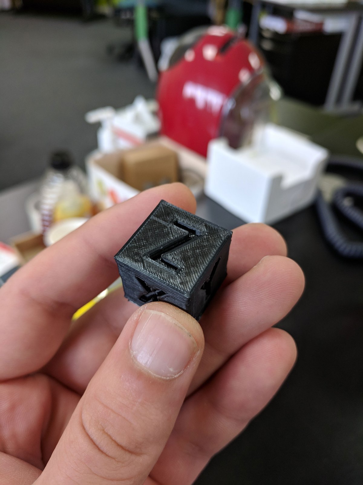

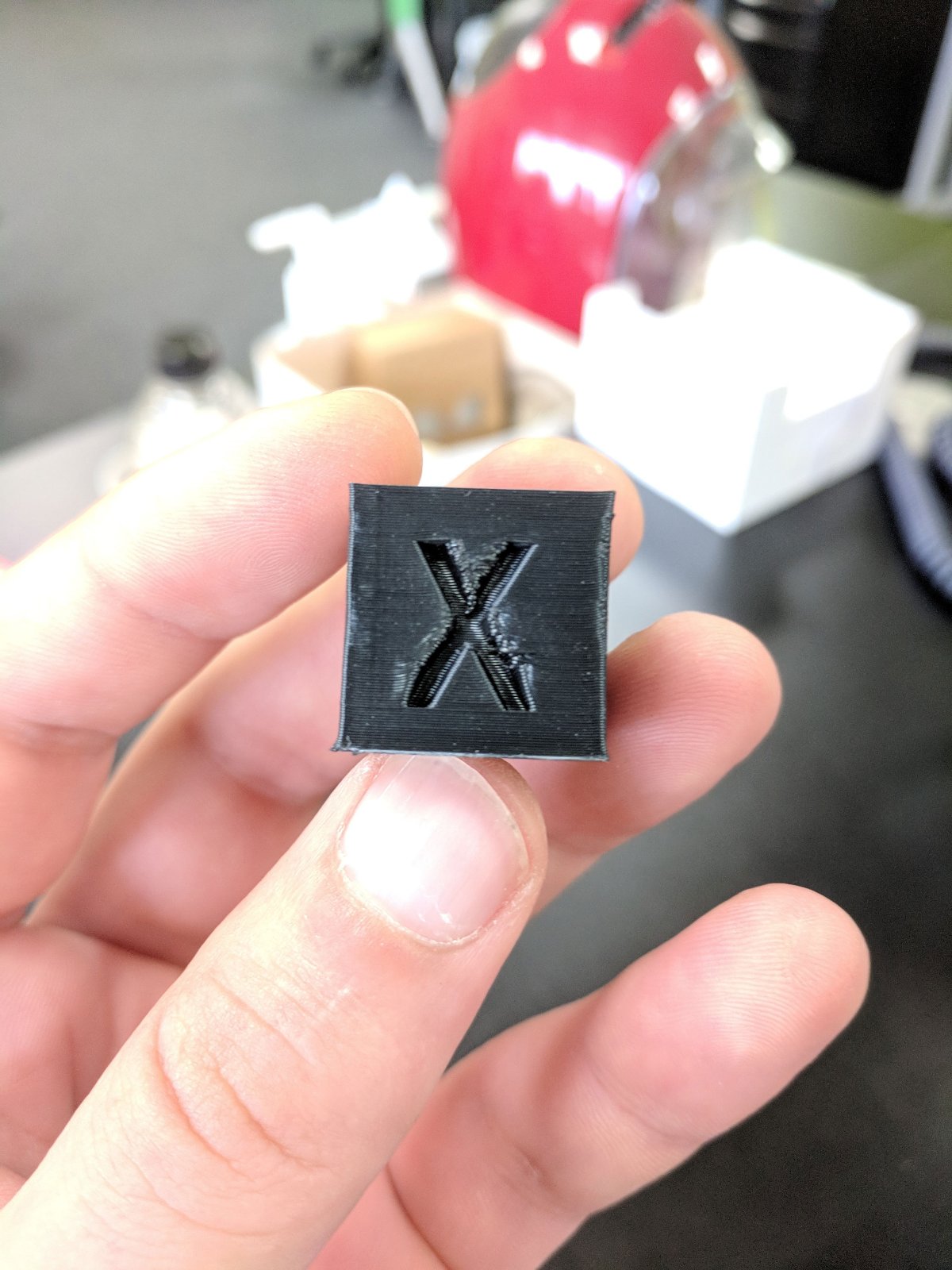

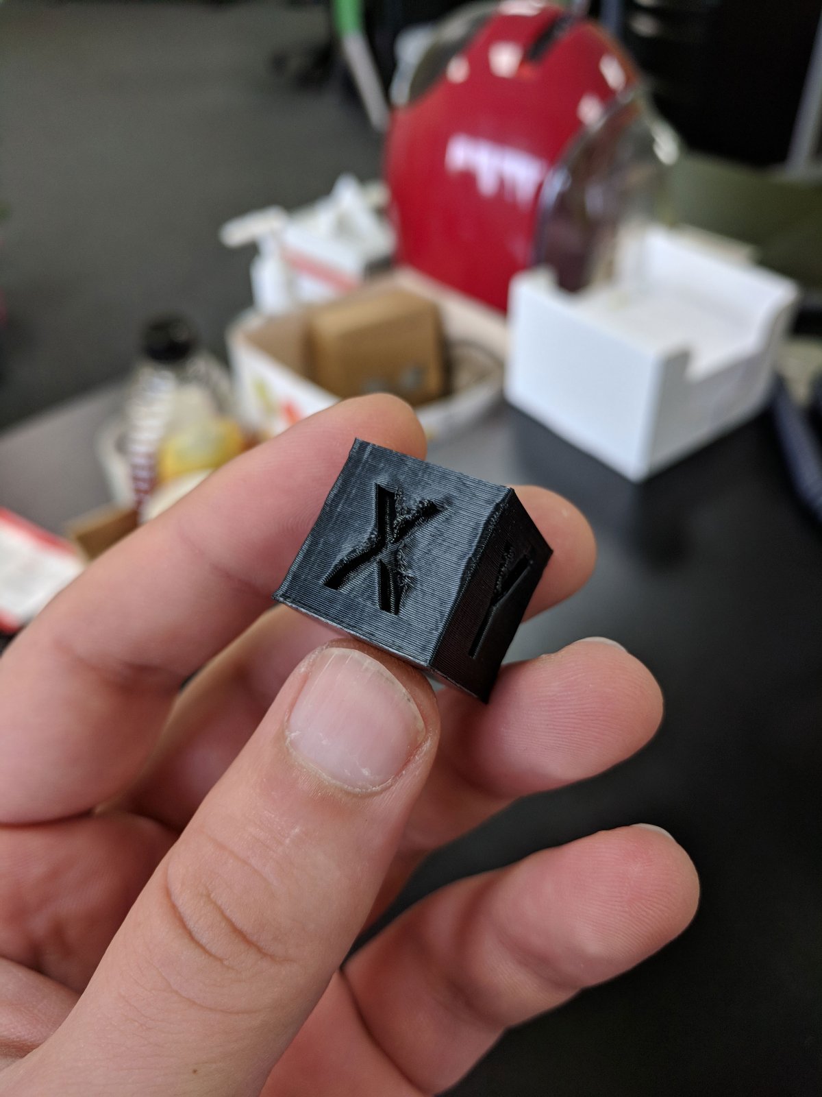

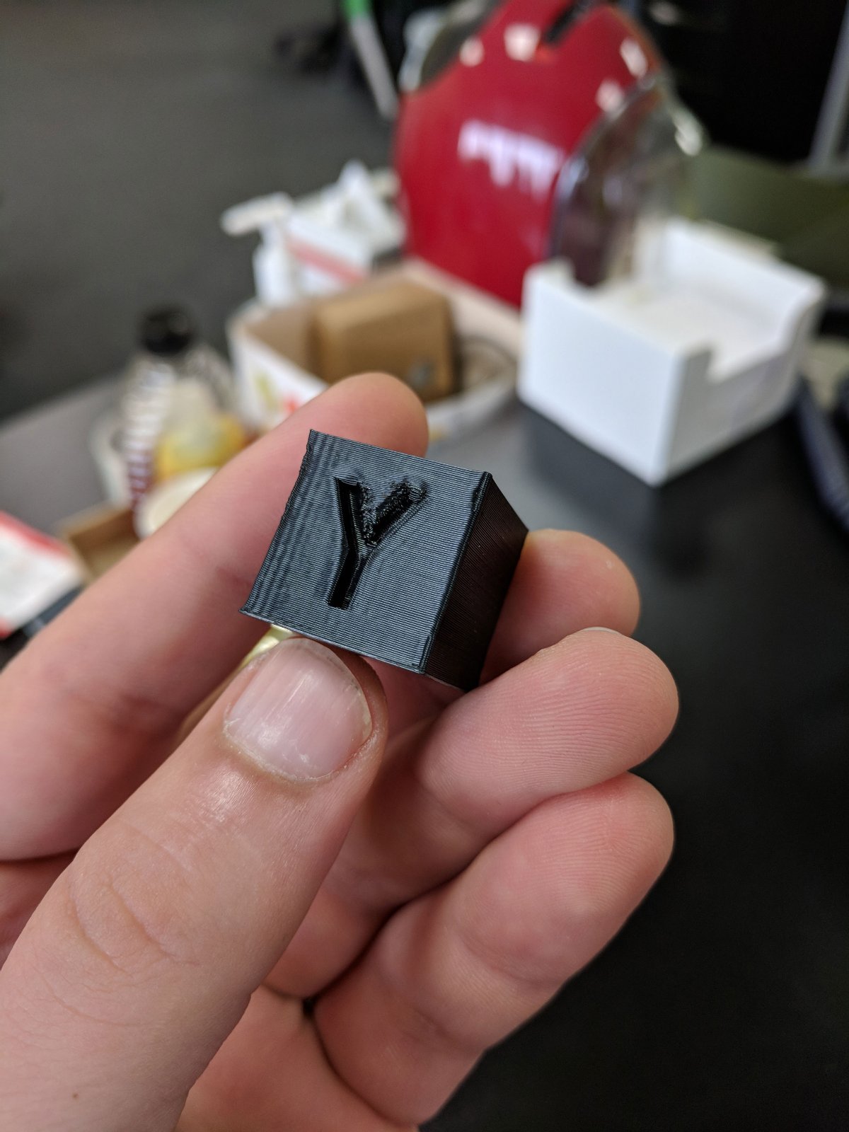

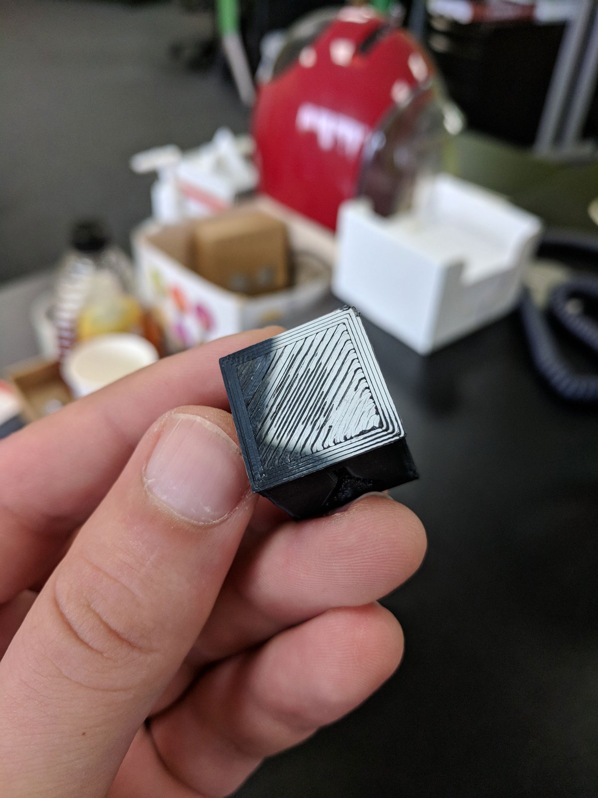

Hi guys,
I hope someone ran into this problem and knows how to fix:D
I've been trying to print the calibration cube but some inconsistencies in the print showed and i don't know how to fix.
Bellow are some images of the cube after printing. Any sort of help is greatly appreciated. Thank you

My limited knowledge points to an overheating issue. Either the head is too hot 200 should be good or lack of cooling on hot end.

Agree with @martinyazz
And for the first and second pictures, you can try to increase the overlap and first layer width.
